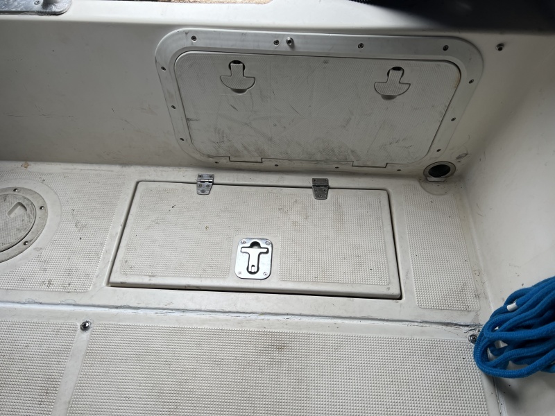

My new hatches arrived today, and I started working on pulling the old ones out. I'm primarily just going to be adding photos of the port side. The starboard side is pretty much a mirror image, so unless I see any differences I'll just show work on the port side.
These first few photos are of my original hatch and it's removal.

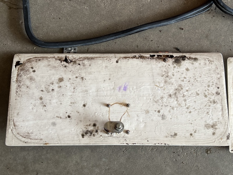

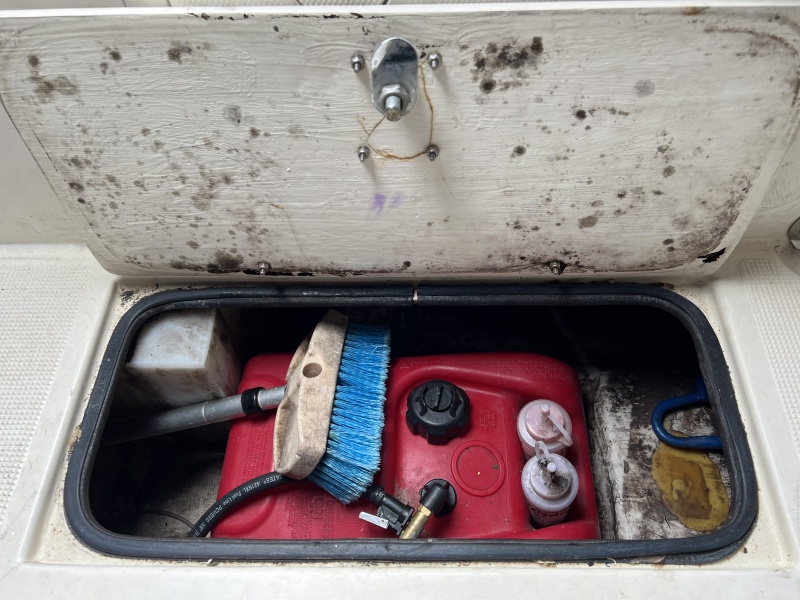

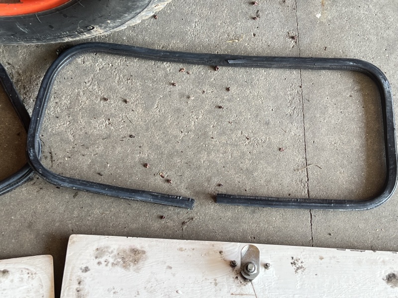

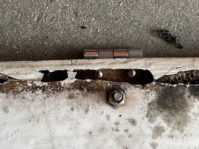

As you can see, the seal is still pretty much intact. However, the bottom of the hatch is curved a bit, and I doubt it is making contact with the seal when closed.
This is the bottom of that hatch. You can see where part of the fiberglass is missing and the core inside is somewhat hollowed out in that area. The next photo is a close up.
Seal removed

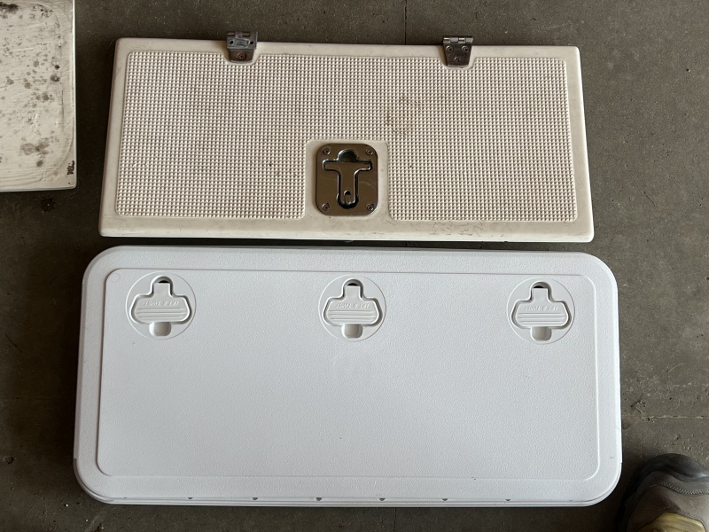

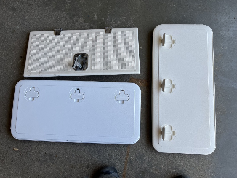

I do want to show the color difference between my old hatch, which is the color of the boat. The new hatch is Polar White. I have to decide by tomorrow if I want to go ahead and paint the new hatches with paint that matches the boat's white. (To give them time to dry/cure before installing.)

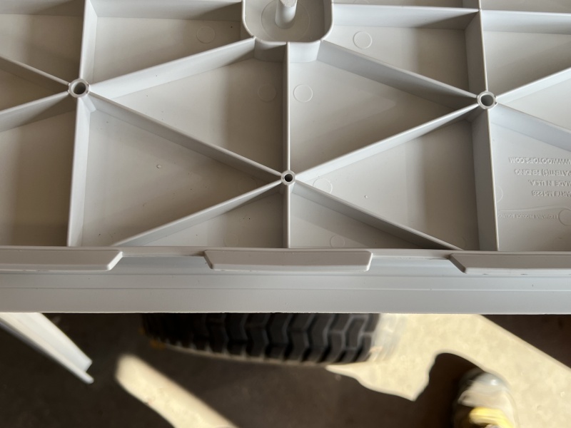

This image shows the tabs on the one edge of the hatch that butts up into the frame, to hold the door in place. The other side has the twist locks.
The frame seems to be bowed out some along the tabbed edge. In one of the other threads, someone asked if this was normal, as they could see the screws holding the frame down, with the hatch closed. I did clamp the frame tight around the hatch and still saw a bit of the screw hole. My plan when I install the frame is to use a straight edge to make sure the frame is square when I drill the screw pilot holes, and then again when I screw it down. Right now, my plans are to over drill the screw holes and use epoxy or auto body filler to then redrill and screw into. (For filling in like this, I've had better luck with body filler than epoxy, when screwing into. Otherwise, I may just let the 4000 protect around the screw hole. (44 holes, 22 holes per hatch) is a lot of overdrilling and epoxying, and I'm not completely convinced it would be necessary to do so with this location, or with the use of the 4000. The screws will not go thru the bottom fiberglass.

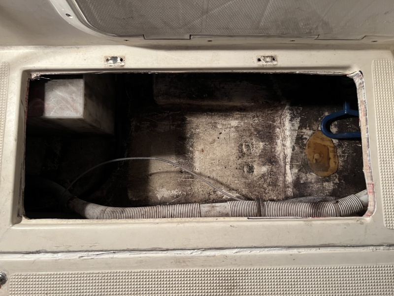

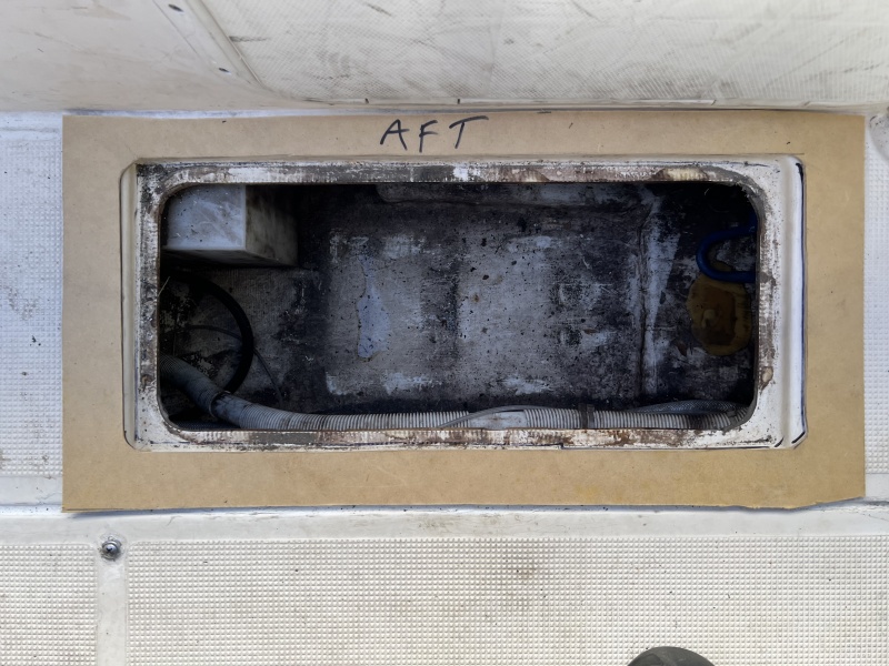

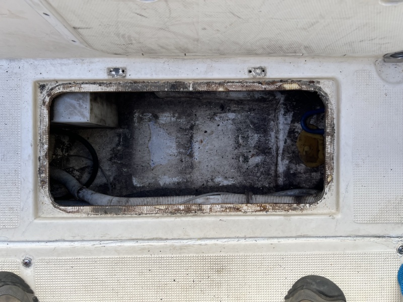

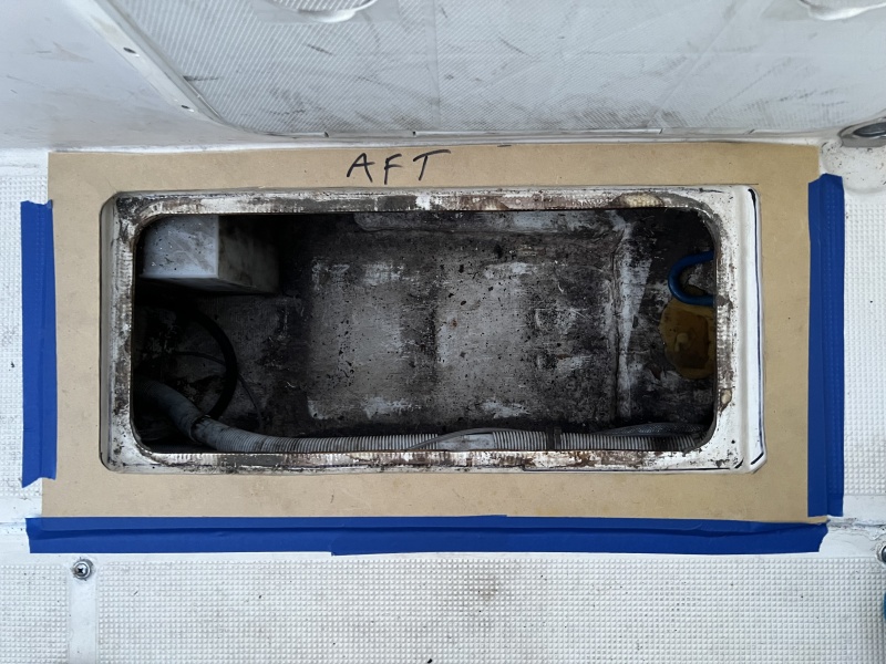

So here is the hatch opening with the old hatch and seal removed.
I made a template from thin particle board, of where I need to cut.
And taped it down to hold it in position.
The cut is made.
I will be cleaning out the original hinge screw holes before I install the new hatches. I'll fill those holes with marine epoxy.

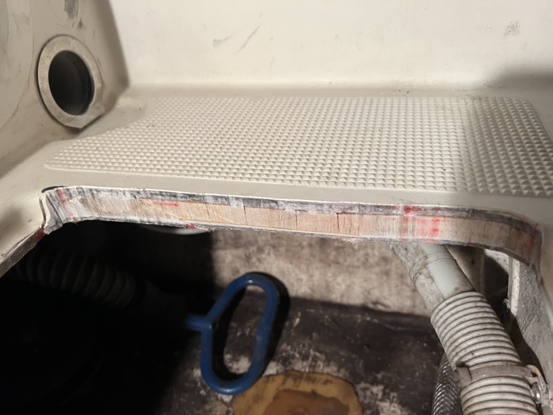

Three of the sides of the hatch opening have the original fiberglass or gel coat protecting the core. You can see the core on the one end in this photo. And it is dry and solid! I think I could just leave this with the protection of the 4000, but I think I'll probably route the core out some and use auto body filler here. In fact, I might just route it out back far enough to where the frame screws will come into it.
I actually need to trim this opening up a bit more as it's just bit to tight for the frame to fit into. Tomorrow I hope to finish cutting the openings, and prepping them to install the hatches on Sunday or Monday. I'm using several tools for cutting the opening up larger. A circular saw, jig saw, and oscillating multi-tool. |

I did go ahead and paint the hatches today. Here you can see the old hatch, the new hatch as polar white, and then the other new hatch I painted. (I painted them both, but for comparison, showing them side by side before I painted it). It is kind of hard to see the actual color in the photos here, but the polar white hatch is next to the old hatch, while the painted hatch is beside the other two. (It's the one on the right in the picture.

I do hear you Bob. And while I know many preach the sealing with epoxy, (and something I frequently do with repairs or new work) I really believe sometimes it's just not necessary. As in when it's above the waterline, or when it's not really possible without doing more damage than good. In my case, the one side of the cutout that opened the core up, the wood was pretty solid. In that even with the right tools I was doing more damage to the surrounding fiberglass/gelcoat than removing wood. And the screw holes were so close to the edge of the opening, I would pretty much of had to rebuild the area to make room to "plug" the area for the screws. So, I did seal the exposed hard wood core with shellac and caulked the screw holes pretty well with the 4000. Which brings up the sealant I used to install the new hatches. And that was with 4000, since I already had it. I have used 4000 with a lot of other material, and have not had any issues with it. I guess time will tell. Anyway, I do appreciate your advice and comments Bob, and have sometimes followed them with other projects and repairs. |

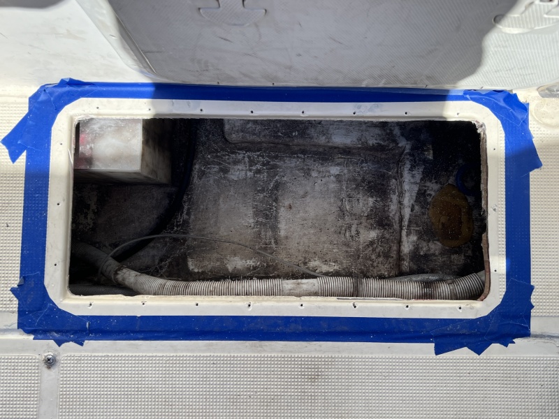

After cleaning everything up, I taped around the hatches to keep the sealant (4000) from spreading out to far.

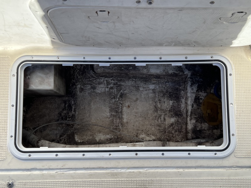

In this image, you can also see how close the screw holes are to the edge of the cutout. It would have been pretty tricky to drill a larger hole along the edge, fill it with epoxy, and then redrill it. I'm pretty confident I have enough sealant to prevent any moisture from getting into those holes. And the screws went in covered with sealant, plus I put some sealant in the holes before installing the screws.

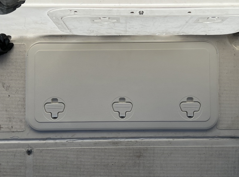

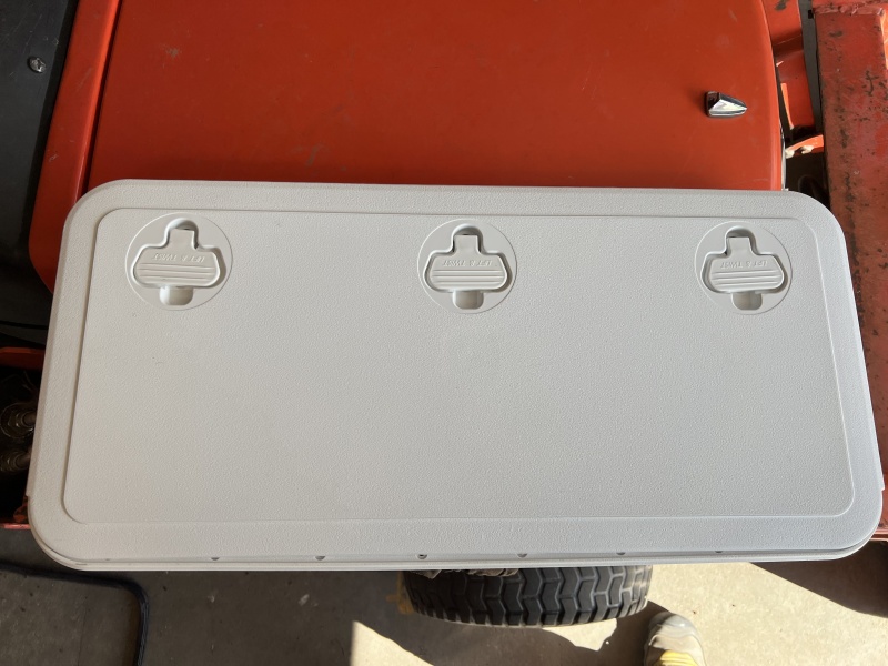

The hatch frame is installed. I used a straight edge along the back to insure that frame was square, as it was bowed out slightly from packaging. The lids do fit tighter than I would like, but I'm hoping they loosen up a bit over time with use.
And the finished product.
The lids are not hinged, but rather use tabs in the back to hold the back in place, while the three latches hold the front in place. I would prefer hinges, but hopefully I won't manage to lose these over the side!
