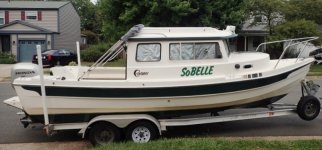

My 22 came with a bimini that the PO put on. It is a 3rd party one from Talyor or Attwood or the like (label is too faded to read). It is 3-bow mounted to the gunwales. Mine does not attach to the cabin roof, but has straps at the front and back.
The advantage to the straps is that the angle of the bimini can be adjusted fore and aft a bit as needed depending on where the sun is. For instance, if the sun is off the stern, the bimini can be angled more to the stern for better protection. The disadvantage to the straps is that it is not attached to the cabin roof and if it is raining, water can come through the gap. This can be mitigated by angling the bimini more to the front.
The bimini is sized so that when it is stowed it rides on the top rear of the cabin roof and is secured to the roof hand rails for towing.
These pictures show the bimini stowed and deployed.
