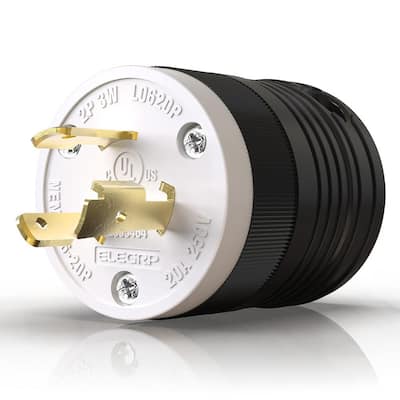

As Ssobol notes the heavy duty cords are available. A true 20 amp plug will usually have the neutral spade connectors horizontal and hot vertical. The output of the extension cord may have a ambiguous (The horizontal slot may also have a vertical slot at the same position)
There are also round 20 amp plugs, some found in marinas. I carry an adaptor for those
