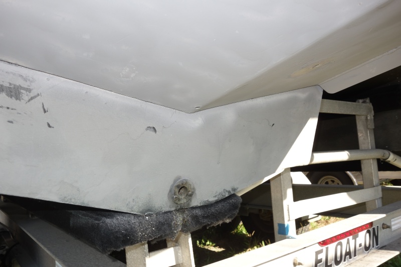

I recently decided to replace the bottompaint on the aluminum bracket since it never lasts as long as that on the sponsons. I’m told that’s because copper is much more effective but of course can’t be used on an aluminum bracket. I had some spots with paint flaking off and tiny starburst zigzags of bare aluminum. I scraped the paint off with a pro scraper down to what was left of the barrier coat of Interlux 2000 (PO had the cans from the dealer). Sanded, cleaned then immediately applied self etching aluminum primer. Here’s the pic after that:
Then two coats Interprotect 2000 epoxy then 2 coats Pettitt Eco.

So yes, the engine bracket should have it’s own anode protection. Mine is a Pooder (cheaper than Armstrong). It came with a 3 inch round CM-3 that fits in the hole pictured to the right. Put a bead of your fav adhesive sealant (I like Boatlife) in a circle on the top and bottom parts to keep water out of the hole and tighten the hex nut. This is much easier with two people with vinyl gloves…one sticks the bolt end up through the hole, the other spins down the other half of the clam shell from the upper access plate. This is another annual change out so don’t use 3M5200. I called the Pooder factory for this advice.
