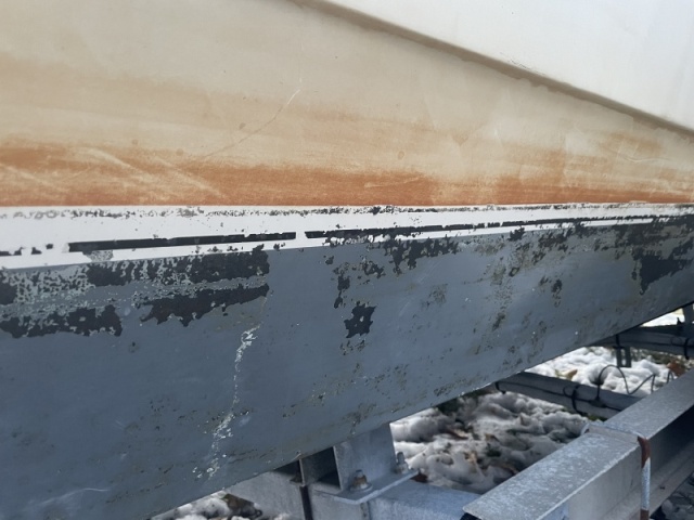

Thanks for the help everyone, just got an album setup and added a photo for reference, not sure how to embed an image quite yet. With that being said my stripes are grey so I’m assuming what I’m looking at is the factory paint and the bottom wasn’t prepped correctly (hence the bottom paint not sticking well.

Here is you photo ( to make it easier for others to comment too.
Lots of colors going on there. Looks like the gray is the factory (NOT paint but gel coat), covered by some black (bottom) paint. You are right, it did not stick well, but then we don't know how long ago it was put on so . . . . . .
And that orangish - browninsh - other color. Looks like tannin stain.
Barrier coat is due first, after a couple other steps too, media blast, and dewaxing.
All the best.
