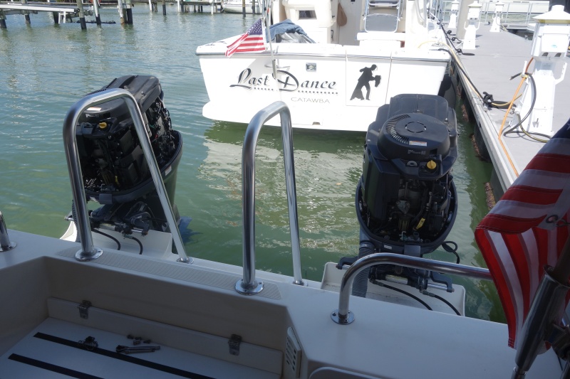

After a few minutes we got an engine overheat alarm on Engine #1 (port in GarminWorld). We raised the drive, and saw no Walmart (rarely, it’s a Sam’s Club) bag or grass around the intakes. Started it back up with good pee streams and another overheat alarm after a few minutes at idle. About five years ago we had similar symptoms with a grungy pressure control valve, so I cut off the good engine and ran the overheating one at 1300RPM to make way with no more alarms. We maneuvered into our slip with both engines at idle with no more alarms. This is the first cruise since our 10 year service in Nov ($5,300 including new water pumps and impellers).
Now we’ll try to get a mobile Yamaha mechanic after three days at the AGLCA Rendevous.
After we got shorepower hooked up and the air conditioning at full blast, I refilled the fresh water tank (we don’t like any unnecessary weight when trailering). The freshwater pump wouldn’t come on. At the end of the troubleshooting list is pulling everything out of the galley cabinet and sponson access cover ( a 45 minute job) to get to the pump. The fuse was OK. I pulled on all the wire connectors and it suddenly purred back to life.
The dead N2K backbone turned out to be due to a fuse that wasn’t blown, but had some tarnish on the legs. It’s back up. It’s a boat, so it’s always something.
Any of you motorheads have an opinion on why a F150 would overheat only at idle?

The mobile Yamaha tech found grass, grunge and sticky sand in the Pressure Relief Valves. (So I was right all along, but She Who Must Be Obeyed must be obeyed, just like on your boat). He replaced both with new gaskets and an upgraded mushroom shape cap that is less likely to get stuck for $65 in parts.
Due to the awful traffic in this high season of south Florida, the travel bill was $145 plus 1 hour labor at $130. Sigh.

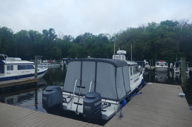

We paid the Yamaha Certified Tech $65 to replace both Pressure Control Valves and $145 for travel for the six miles to the Pink Shell in awful traffic.
The engines purred for over an hour with no idle overheat alarms.
We ran on plane for 30 minutes to our Punta Rassa ramp takeout and idled for 40 minutes with no overheat alarms We then loaded the boat on the trailer and took off for Ed Stone Park.
After launching at Ed Stone, we escorted a newbie down river at just above idle speeds. Less than a mile from Hontoon, their engine died. It would crank but not start and neither would their kicker. We turned around and headed back to them while my engines were having a conversation as the sun went down.
My Engine #1:
“Yo, Number 2. I think this would be a really funny time to throw off another overheat alarm. It would be funnier if we do it together with no debris in the water. You with me, Bro?”
Engine #2:
“I’m not sure they would fall for that. He’s gullible, but not entirely stupid. Why don’t you go first?”
We approach their boat as the #1 overheat alarm starts shrieking. The digital readout from the ECM to N2K backbone is 129 and 131.
Me: “Dang it” (or something like that), “Shutting down #1. Eileen, tie ‘em off on a hip tie to their bow and stern cleats…we won’t have much maneuvering power.”
I was right about one thing…we didn’t have much maneuvering power on one engine.
We radioed the Hoot about our predicament and Our Fearless Leader Tom on C-Otter assembled a gaggle of helpers at the end of the T-Dock. He refused to send out a boat with four to eight stiff drinks to help make the docking less stressful as night fell. He mentioned several times to hurry up because he was missing dessert. He’s so mean, but you already knew that.
Engine #1:
“Hey #2, this would be a really funny time for you to throw off a Low Oil Pressure Alarm…whaddaya say?”
Engine #2:
“Well, they really treat us rather well, and I’m not sure I’d rather be hanging off the transom of some panga in Sri Lanka next month with no zincs, so I’ll take a pass today but agree it would be really funny.”
We (such decisions on our boat always come with veto power by the other) decided to restart #1 just before dockfall (to coin a word) regardless of any alarms to get the needed maneuverability. We had no overheat alarm as #1 thought about the availability of Yamaha M4 oil in Sri Lanka and whether Sri Lankans would really add Yamaha Ring Free ($50 a quart here with HAZMAT shipping) to the E0 gas, assuming there is any E0 gas in Sri Lanka.
Dockfall was uneventful with a minimum of splintered cross beams and broken pilings.
The Newbie changed out his fuel/water filter the next day and his engine purred to life. The next day after that they cruised upriver with no issues.
Today’s agenda (last day) includes idling over to Holly Bluff for a pump-out,
hopefully without creating a sewage geyser (Thar she blows!). They rent 60 foot houseboats and the pump is powered by an old locomotive engine that’s a bit too powerful.
By the way, if you’re reading this, Engine #1, there are even worse places to end up than Sri Lanka.
