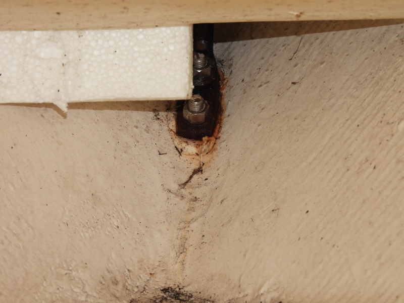

so, we're going to take out the bow eye (2006 16' cruiser) because it looks like something's leaking up there, so we can epoxy, redrill, etc., - we're slowly doing that on all of our fittings. This is a pic with a camera with zoom, boy, it's difficult to get in there (and I'm Karen - 5' and 125#). Is there anything we can or should do when we take it out to shore it up, I can't believe that little ring through the hull is good by itself - But what do I know Smile Also, isn't there some manufacturer that makes a system where the bolts are tightened from the outside! Obviously, I'm not looking forward to going under there and unbolting and rebolting that unit while the hubby holds the outside lol thanks!

Ksren, Yes it looks like it is due to change out. NO, I don't think there is any that will have the threads on the outside to put the nuts on out there. Sorry. Yes it is tight and Small. Good luck.

and I can't imagine why that funny piece of foam is there Smile I guess I'll find out when I dive in!

The bow eye and locking nuts are probably good quality SS. They can be cleaned up and reused. It is whatever they used for the backing plate that is badly rusted . Replace that with a SS plate and re tighten.
A cordless impact driver with a long extension and swivel socket would save you getting all the way in there and turning it by hand.
I am not familiar with the 16 but if the purpose of epoxy and redrilling is to seal the core, I don't think you will find any core material in that section of your boat. I would personally just reuse the u-bolt for raison mention above by Rob but definitely replace the backing plate asap. You could use something like this to be able to tighten from outside

Agree, you most likely have to put in new bedding compound. I would probably use 3M 4000. Tape off around the outside, so you don't get it on the gel coat. It may be hard to find the exact backing plate in SS. I would get a local machine shop to make one out of 1/8" thick to 3/16" thick 316 stainless steel. Clean up the U bolt and nuts, re-install.

I'd replace the nuts with aircraft nuts (also called nylon locking nuts) - that's just me. They will be harder to turn but that's the idea - not to get loose.
MTCW, Jay
Posts: 21378
PostPosted: Thu Jan 06, 2022 10:23 pm    Post subject: Reply with quote
Nyloc nuts (as above) are an option, But I prefer to use a full thread nut 316 SS nut with Loctite 424. That gives a very secure fastening.

No argument with Dr Bob. Also I like the unique bow eye C-Wolf showed; would Dr Bob like the thin nut on the forward part of the eye? You could always replace it with a full thread nut; maybe not as good looking but safety isn't about looks.
Although there is little strain on the bow eye of a 16, I would feel better with a full thread nut. I used to tow a 20' Grady White behind a trawler, and in that case we fabricated a full tow fitting much stronger than a toe eye.
I have seen tow eyes pulled out of the bow of boats--due to improper spreading of the load--but probably not from nut failure.

The forward nuts only keep the u-bolt from getting push back in, while tugging on it, all the pressure is on the backside (against the backing plate😁). That’s what I had on my previous boat for the trailer straps. I’ll add a picture soon.

Not all have the forward nuts. I suspect they are put there because some boats are not going to be even where the holes are drilled, and irregularities can be adjusted for. But I would not just tighten nuts from the outside. Keep those as close to the "U" as possible.
