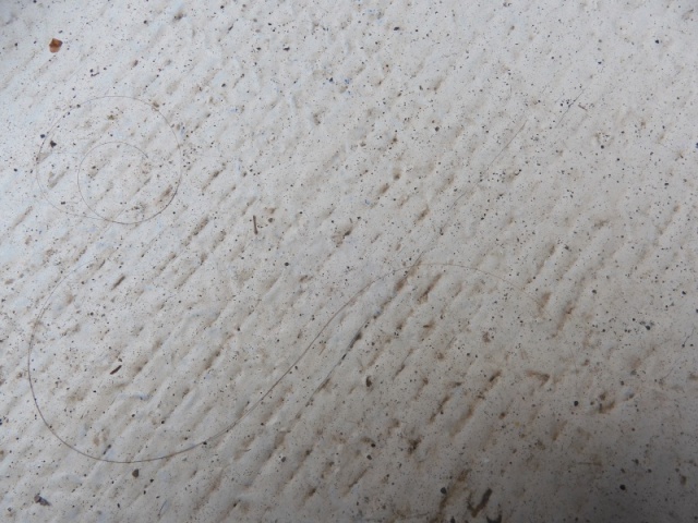

Now that I look more closely, it's not all that bumpy, maybe 1/8 inch, but that 1/8 holds a lot of dirt. Maybe just a good coat of deck paint will even things out enough. I looked at both Kiwi and Awlgrip, mostly good reviews, but a lot of people said it was very hard to clean and/or didn't adhere well. I like the flat look of the current paint, maybe I should just use some good latex flat, and call it good until it needs to be repainted Smile Here's a pic - excuse the hair Smile
PostPosted: Thu Dec 30, 2021 9:29 pm    Post subject: Reply with quote
That looks pretty stock. Think I would try some Non-Skid cleaner. Spray on, let it sit then hose it off. Will get ride of 90% of that dirt.

Posts: 21378
PostPosted: Fri Dec 31, 2021 3:57 pm    Post subject: Reply with quote
What you are seeing in the photo is 24 Oz woven roving with a minimal of gel coat over it. That is part of the structure of the boat--so don't sand it down! You can lay in any number of products or you can give a good deep cleaning periodically. Best to just lay down the Dri-Dek.
