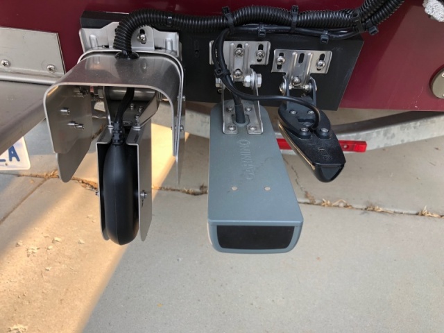

Here's three as long as you are using different frequencies they will work if you set two of them to the same freq. you will see diagonal lines scrolling through the screen. The last trip to lake Powell I clipped a cottonwood tree with the forword sonar and it removed it from the boat. I just need to remount it.

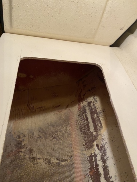

I might be even crazier then the OP but, what about mounting the transducer in hull under the v-berth. On my boat (2006 M Y), the wood core stop a few inches forward of the v-berth bulkhead.
On my previous sailboat I did install a very basic dual frequency transom mount model transducer in a big blub of silicon forward in the boat (had to go past the lead ballast) . That was just for basic deep reading at slow speed, but it work just fine for my need at the time.
Not very obvious but the wood core stop a bit aft of the edge of the shade. I could get better pictures if anyone is interested.

The current Garmin transducer is the ps22-tr it sees 300 feet in front and 300 feet down and is live sonar. It will show anything in it’s view down to fishing lures. Here is a link to the old thread.
http://www.c-brats.com/viewtopic.php?t=26691
