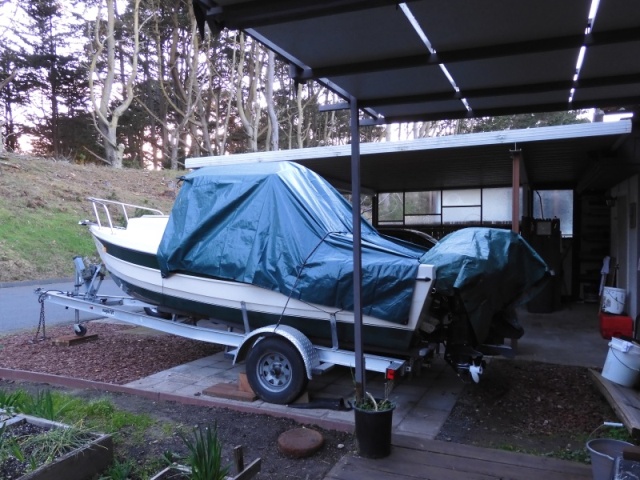

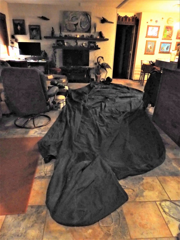

Thanks Bob, today I bought a 10x12 tarp and put it up to annoy the neighbors for a few days Smile Actually, if I cut it to fit it might be serviceable for a bit, easy to get in and out of as we work on the boat over the winter. At the same time, I've decided to cut up the original cover that came with the boat, the one that covers clear from the anchor back to over the motors. A lot of the stitching was going bad anyway, this way we can put it on and decide how we want to piece it back together in sections so that it's easier to put on, maybe do away with the bow section and make the motor cover separate. Anyway, cutting away the motor section tonight, I was really impressed with the quality of workmanship of the cover from 2006 - just some stitching giving way Smile

In my photos I have a folder called "Poor Man's Boat Cover" where I used a $20 plastic tarp "customized" to fit my 16. I threw it over, marked it with a Sharpie as to where to cut darts in the appropriate places, and then used duct tape to make the seams. I only use it when I have a big project in the shop. It keeps pitch and needles off of the boat for a couple of weeks and then the boat goes back in the garage. The PVC pipe frame helps with moisture if it's outside for more than a week.

Thanks Marco, good idea, we're starting down that road until we build a roof over it. Is the PVC just to keep the tarp away from the boat surface?

just some stitching giving way.
Most covers are sewn with Dacron thread. This will give out from the UV light in 5 to 7 years (average). If Tenara thread (Gortex) is UV resistant. (this costs almost 10X the Dacron UV treated thread. The seams can be sewn back or even sewn over. Not an expensive thing to have done.

johnr, yes, we have a full canvas cover (see photo above filling our living room) from motor to anchor from Angola from 2011 - it even has a tag on it with the person's name on it who made it and a smiley face, just found that, kind of cute Smile
But it was really really neglected, with moss even growing on it, so we're cleaning it up, repairing it, then putting a new coat of waterproofing on it. Not easy now that we've entered the rainy season Smile Thus the need for a temporary cover, so we're doing like Marco with the poor man's tarp cover for now.
It's raining out today, and for some reason I have more confidence in the poly cover than I do for the canvas (we can get 5 to 10 days of rain in a row here), but maybe I'm wrong. Just not sure how clean we can get the original canvas so that it will "take" a new waterproofing (have 303 marine water guard on order).

The PVC pipe is to ensure that there is enough ventilation under the cover. If closed up too tight, you will get mildew even if everything is removed from the boat. I see this all the time where people are asking advice on mechanical or chemical methods to stop mildew in a boat that is closed up tight. I try to leave as open as possible without actual rain coming in (hatches and windows open under the cover). Much easier to remove a couple of spiders than mold and mildew.

thanks Marco, all too familiar with the air flow needs in a damp environment! So we have a half poor man's cover for the coming rain, while we continue to work on the canvas cover - hard to do with it raining Smile The tarp has actually kept it quite dry inside, and so easy to get in and out of.
