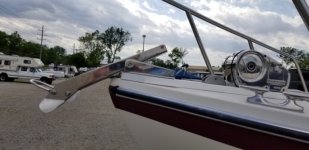

My 25' didn't come with chocks in the bow area. I am planning on installing them and would like to hear form anyone who has installed them and could give me any insight as to what size to install and any issues I may encounter while installing them.
Currently I am thinking the 4 1/2" stainless Whitecap brand may be what i'll use.
Thanks, Dave

You might consider what many of us have done on the bow of the 25. We have put secondary cleats, in the area where you might normally put chocks. None of the boats came with chocks from the factory to the best of my knowledge.
The secondary cleats are great for dock lines, and spring lines/shock absorber when anchoring.
These cleats can be placed anywhere. There is a 1/8 round SS rub strip to avoid abrasion on the fiberglass.

I have done the same as in Thataway's photo, I probably got the idea from him.
When I anchor I always place a snubber line tied with a prussic knot onto the anchor rode and then slacken off the rode so that it doesn't chafe the rode on the bow rollers. They are also useful for tying off at a dock. Mine are about 8 inches total and I used large SS washers under the berth and sealed the holes well with epoxy.

Thank you Bob and Peter, I hadn't considered adding cleats in this location as I felt it was somewhat redundant as there is a cleat already in place. However after seeing what the configuration looks like on Thataway I may have to reevaluate my options.
