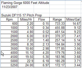

The only one I have is at 6000 feet

Boats 21 feet or longer are not required to have the tag and is only a recommendation. My 22 never had a tag from the factory and they installed a Suzuki DF-115 on it at the factory shortly after that the new tags were changed to say 115. My boat now has a Suzuki DF-140 on it. Loaded semi heavy at Lake Powell I could reach the lower end of WOT with a 17 pitch Solas 3 Blade SS prop.
5600 RPM
10.1 GPH
2.4 MPG
23.8 MPH
5000 RPM
7.1 GPH
2.6 MPG
18.5 MPH
2100 RPM
1.0 GPH
5.7 MPG
5.7 MPH
