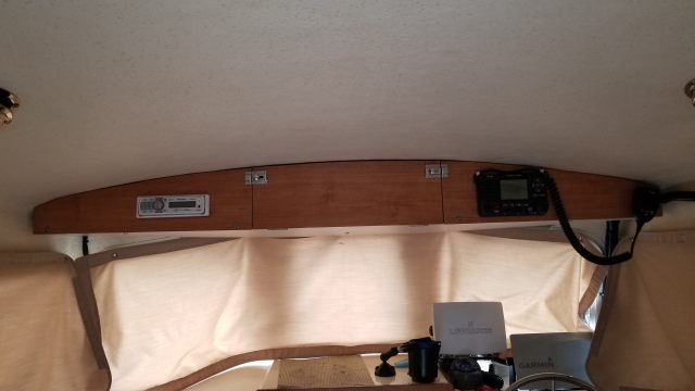

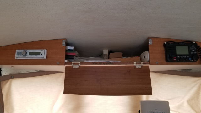

I found the original overhead shelf lacking in usefulness.
The space from the shelf to the roof was narrow and didn't allow much to be stored up there except for folded charts, books, etc. , which would all come falling down from the rear of the shelf by the windshield in even moderate seas. There was no shelf lip or rail to stop stuff exiting the shelf. The stuff would fall out the front as well, even though the teak lip was there.
So, decided to make a new shelf. I used 3/4" plywood sign board and painted it with melamime. I put plywood spacers painted with epoxy to extend the existing mounting points allowing for a wider shelf space. Finished with a teak front and hinged door. Used 1/4" plywood pieces on the rear of the shelf to stop stuff from falling out.

garyf
