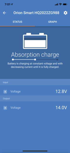

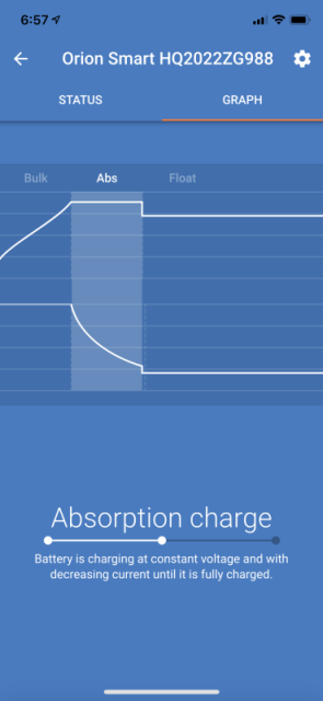

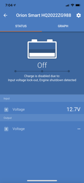

I setup a couple batteries on the bench to test it. Here are some images off of the phone.
Middle photo input voltage is lower and the boost function is working. I will need to put a switch in the input leads so it can be turn off.
