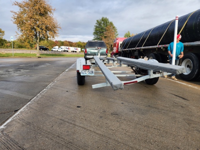

I flew back to St. Louis yesterday to pickup the trailer and head back to Nashville. Shortly after getting on the road, I noticed my port-side trailer guide missing. When I stopped to see what had happened, I saw this:
Shocked
Essentially the tube that connects the aft section of the trailer, and to which the back bunk supports are attached, pulled out of the two U-bolts that hold it to the aluminum I-Beam on the port side. I didn't notice their being loose when doing my walk-around of the trailer before leaving, but obviously they weren't tight enough.
I managed to use some straps to pull the tube closer to the I-beam and raise it slightly and limped back to the trailer repair place I (mostly) trust. They won't be able to look at it until Monday, so won't have more information until then.
My main concern is that the distance between the I-beams is now roughly 6 inches greater than if the bar was connected, so it's not as simple as replacing the U bolts and reconnecting the bar. Not sure if the frame is intentionally "sprung" to maintain tension when assembled, of if the difference represents a bigger problem.

I hate trailers and I'm sorry yours is broken. But, if I am seeing this correctly, the butt end of the trailer where the failure happened is also the cross member tying it all together. And without it, it's free to move all over the place - at least, for the most part. It's hard to tell, could be just the camera angle, but are missing a piece of the i-beam? Anyway, if you are not, I don't see why with the right tools it wouldn't go back together if nothing is bent or broken. And if it is, that what welders are for. I have repaired worse! But I don't know without seeing it.

Good news - the trailer shop was able to re-attach that back support without having to bend/force/weld anything. That support is attached on both sides to the aluminum I-beams. The U bolts holding them had apparently loosened enough that without the weight of the boat, the beam shifted and fell out of the U bolts on the left side (hidden by the license plate in the above photo).

Eye balling the trailer pictured is way too light for a 25. The load rite is the way to go. I made the same mistake on my first 25 where I had a trailer built locally. "building a trailer" is basically putting together standard parts. There have been some shortages in the last few years, which may impact getting a new trailer in a short time period.
Running a trailer with no boat on it, is very hard on the trailer--and I have done it a number of times. They bounce all over the place, and vibration is an issue. This is probably what caused the failure. But you are absolutely correct, it could have been a catastrophe if the failure occurs with the boat on it. I would be careful watching for bumps in the road, where resonant frequencies are set up with the trailer and road. I would be trailering slower than usual, getting the boat home.
