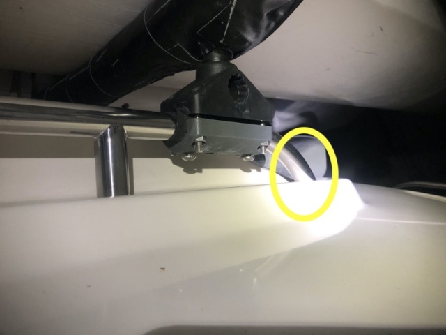

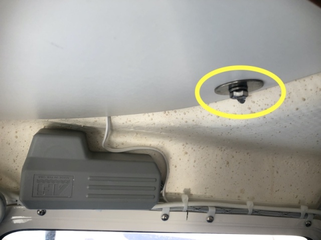

Docked overnight as a thunderstorm passed by followed by half inch of rain. This morning I see a slow drip of water around the through-roof bolt holding the starboard roof rack rail.
Wondering if anyone has a suggestion for investigating/repairing this leak?

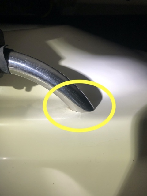

This leak seems to originate at the front roof rack bolt (starboard side). My hand holds are through-bolted to the overhanging visor.
Here is where I think the leak originates:
