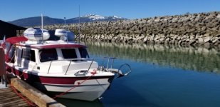

As Bob describes, the cabin roof will be your only practical option unless you construct something like Harvey has on SleepyC:
This would work only if you don't already have a bimini or camperback.
The orientation on the cabin roof will depend on other stuff you have on the roof. Our boat has a radar dome at the front, so we orient the dinghy facing aft:
A davit is my next investment, as wrestling the dinghy back up onto the roof from the bow is challenging and probably less than totally safe.
Les and Kel Rohlf
PostPosted: Fri Aug 13, 2021 5:09 pm    Post subject: Reply with quote
Thanks Les for finding my one off storage place Laughing AS Less mentioned, that works unless you have a Bimini or camper-back Or, if you use the inflatable as a substitute for either of those. I use my dingy less often than some, but it works for both shade and rain cover, and sometimes for a shower, ( and water heater too -- black bottom up).
