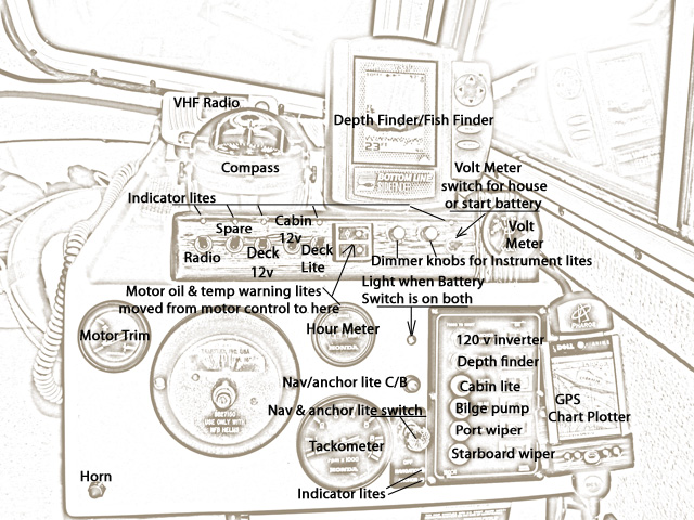

Figured I would post some pictures of my boat projects/modifications.
This is what my dash looks like now. I like to see when anything is on and be able to turn everything on or off, from the captains chair.
Actual photos are HERE in my Boat Projects Album. The photo of the above is towards the end of the album.

PostPosted: Thu Jan 26, 2006 11:07 am    Post subject: Reply with quote
Dave-
First class work and thinking!!!!
Escellent use of limited space!
Great examples for others to follow.
Great re-wiring job!
Joe.

PostPosted: Thu Jan 26, 2006 11:39 am    Post subject: Reply with quote
does the compass work that close to the radio?
PostPosted: Thu Jan 26, 2006 1:48 pm    Post subject: Reply with quote
A lot depends on where the radio speaker is. It looks like this may be one of the removable head types where the speaker and power stuff is separate. It's the magnet in the speaker and large masses of metal that futz up the compass....

PostPosted: Thu Jan 26, 2006 6:02 pm    Post subject: Reply with quote
It did not seem to affect it in my shed. If you look at the last photo in my Boat Projects Album, you will see there is quite a bit of separation between the radio and compass. I turned everything on, in and on my boat to see if the compass moved and there was none. I also removed the radio and still no change, so I feel fairly confident that there will be no affect. I do carry a hand held compass with me all the time, so will double check when I get on the water.

PostPosted: Fri Jan 27, 2006 10:37 am    Post subject: Reply with quote
Dave, I really have to compliment you on the great annotated photo of your instrument layout; it speaks!

PostPosted: Fri Jan 27, 2006 11:00 am    Post subject: Reply with quote
nice looking piece of work there, I especially like the engine indicator lights on the dash, that's a durn good idea that I could see usoing on our boat...as it is now I can't see the lights on the controls.

PostPosted: Fri Jan 27, 2006 3:53 pm    Post subject: Reply with quote
cool fantom pic of your dash area... that would make for a great looking background for some boating cards. ...or other similar boating pictures processed the same way.
