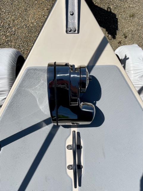

Looking at adding an 8" cleat between the windless and bow roller. Would offset it by 2" +- to ensure the rode rides free. See my photo album for approximate position. Any advice would be appreciated.

You have already have two good cleats at the edges. You can use those for anchoring with a snubber system, but if you want another cleat I see no problem in adding one, and your position seems like it would work without adding undo side pull stress to the roller.

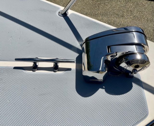

Thanks for the tips. I installed the cleat as planned (see photo album). This is for a short anchorage while we spend the afternoon or a calm night. In a blow I can always secure the rode through the two forward cleats with a snubber.

Be sure that the rode does not chafe on the aft, port side of the bow roller piece. You have more room on the 29 than the 22 or 25 have.

I start my first turn on the starboard side of the cleat and it clears the aft end of the roller. It was a fine line to make sure the chain did not ride along the bottom of the cleat. No room aft of the windless to install it.

Would there be any downside to using a camlock type cleat in this location? As you mention, I don't have room for a regular cleat positioned like this, but a cam would fit.

Gary, I didn't see a Windlass on the one photo in your album of the side of the boat. How much room is there from the back of your windlass (which I suspect you installed after you bought the boat) and the cleat which is there? If only an half an inch, you can still use that cleat, and let the rode rest against the side of the windlass.
I have used a lot of various types of cam cleats in my racing sail boats. But I would not trust one for an anchor rode. There are some line stoppers, but they require that the line goes thru the stopper all of the time. That will not work with a chain!
Generally one should use snubbers when riding to an anchor for any length of time. That is the reason that many of us have installed cleats on the outer part of the deck by the gunnel.
Some have chain stoppers on the deck before the windlass. I have taken those off boats which I have owned. They don't allow any shock absorption if used to secure the chain. OK if you have a snubber or two on the chain... you still need a cleat if you get to the rope part of the rode.

I've got a good 1.25" between the cleat and the windlass. I guess it makes sense to go around the side of the windlass now that you mention it.
