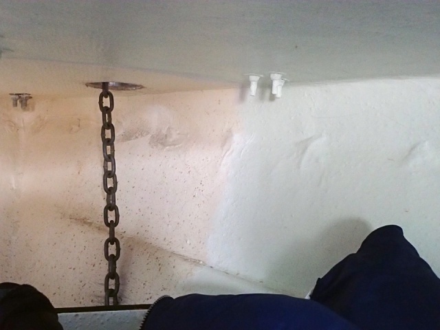

I was surprised to see the interior of the cabin is painted. For some reason I had assumed it was gelcoat also. I am going to need to patch a bunch of areas in the cabin. Does anybody know what type of paint was used? Does it matter what type of paint I use to repaint in the cabin?
Thanks!

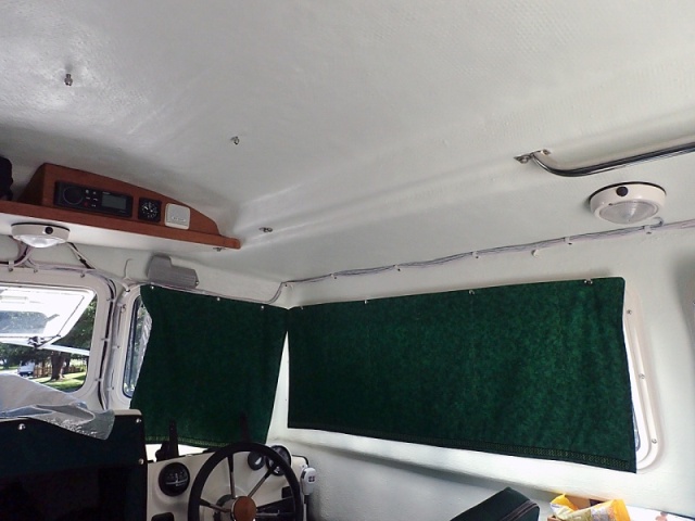

My cabin had a few chips, so I took one to the Spectrum Paint store, and they did a perfect color match. They said “PPG Breakthrough” will stick to anything, and it certainly did. It was a satin finish.
Although the painted area blended in perfectly, later on, I painted the entire cabin. It looks fresh and new

I painted mine with paint from Home Depot. Satin finish. Makes the interior much nicer.
