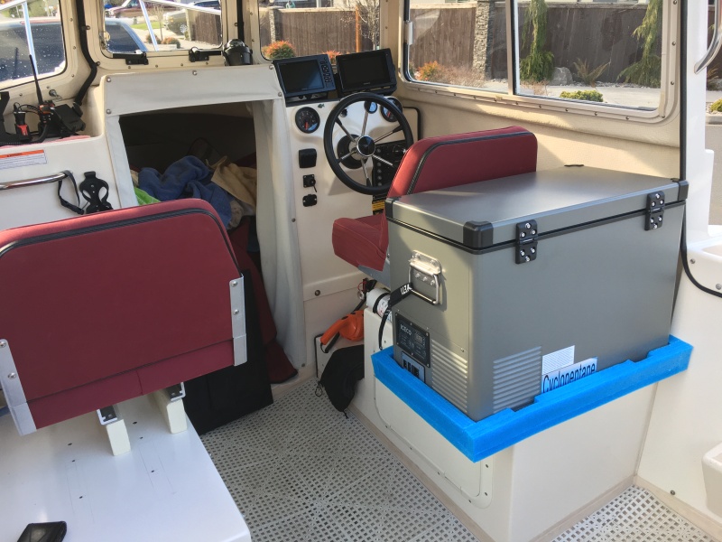

My Iceco VL45 has been working well.
With it mounted behind the captain's seat, the unit is out of the elements and does not take up aft cockpit space.
The blue shipping foam helps to absorb road shock while towing.

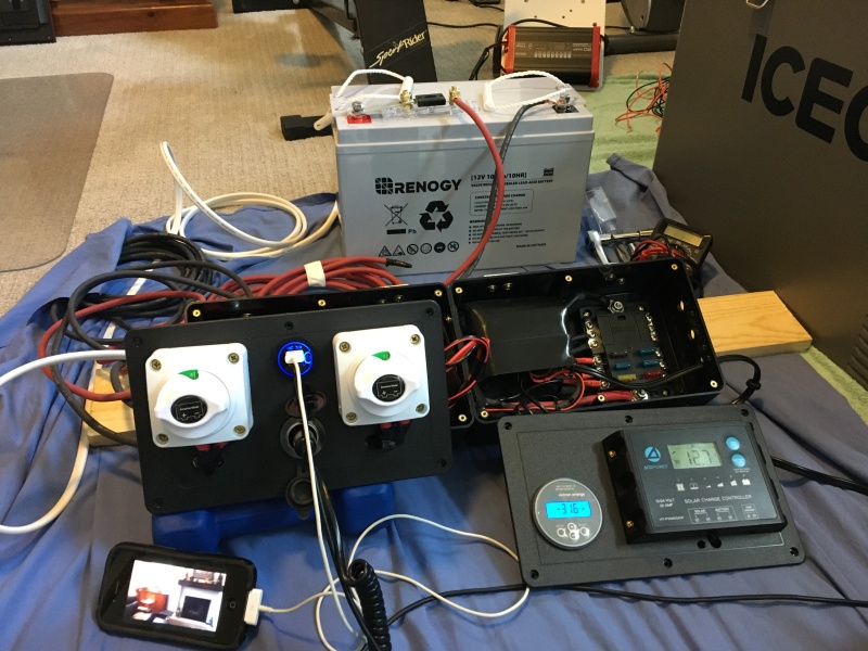

The unit we bought recently uses the same motor, and many of the controls seem the same. I am making a 100 amp hour LiFePO4 power box to run it in our SUV for a road trip next month. I have a 10 amp Li charger for AC mains power, and a Victron battery to battery charger to run off the vehicle alternator. All of this will fit in a double Golf Cart battery box. I will be monoriting with a cheaper meter than the Victron--I'll give some numbers as I develop the system. (Waiting for some more parts--need the battery box, and some more Anderson Pole Connectors, wire etc. I will have a wireless thermometer in the box to monitor the temperature from outside.
