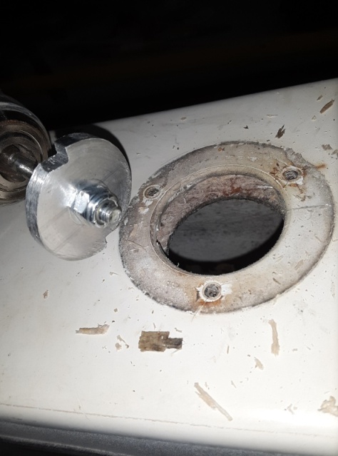

For large areas like the lazarettes, fuel fills, windlass, ect you can make a simple tool from 1/4" alum and a 1/4" bolt and chuck it up in a drill.
