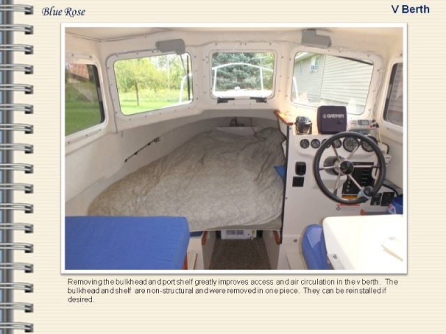

Instead of just cutting the bulkhead out below the shelf to open up the berth area, we removed the shelf too. I have never seen the bulkhead and shelf removed on a 25 but don't see why it wouldn't work like it does on our 22.
Filling in the middle with a new cushion makes a one big bed instead of 2 skinny ones. We sleep feet to the bow and think this is the best mod we have made to the boat. (We can easily put the bulkhead and shelf back in with 4 bolts if we ever want to.)

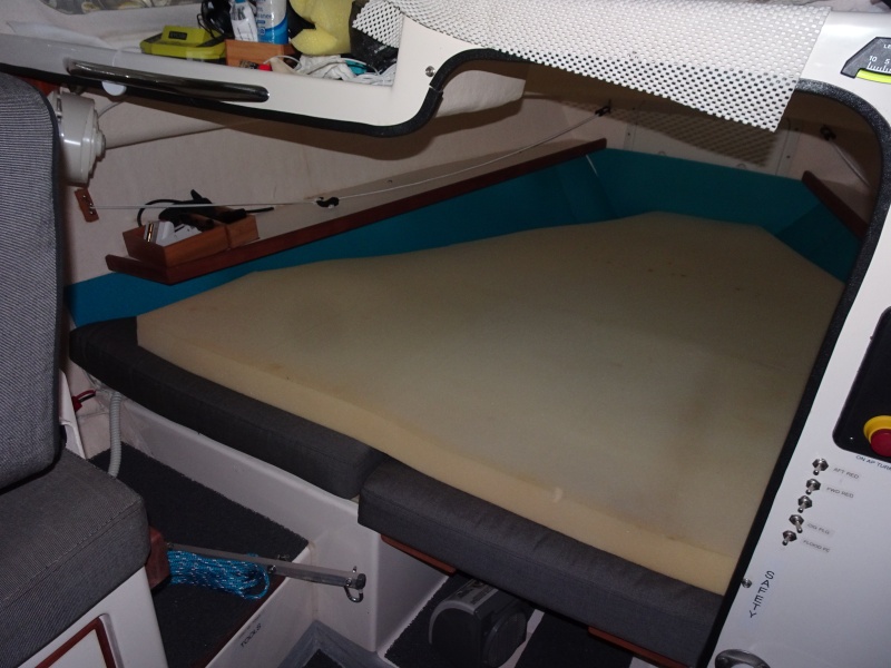

Check with Pat and Patty Anderson. I believe they removed their bulkhead.
Edit: http://www.c-brats.com/modules.php?set_albumName=album146&id=IMGP0755&op=modload&name=gallery&file=index&include=view_photo.php

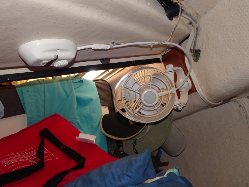

Yes, Thataway C Dory 25 has the entire port side bulkhead removed. it does make v Berth entry easier.
Here is a photo taken mostly to show the fan / light and remote control for it, from the port side berth looking aft. In this case we have the boat packed and on a trip. I put the throwable cushion over some other gear, which extends the bunk pillow area.
Since Marie likes to sit in the aft dinette seat, we leave the forward seat facing aft all of the time. In our Tom Cat 255 (which comes without bulkhead), we had a cushion made for the foot well, which extended the bunk area.

Well, I thought that bulkhead had structural value. The shelf is pop riveted at the top, but there are lag screws along the bottom. It has to give the hull some stiffness. I'd be interested what led smecan(Tosca) to make that statement.
I do agree that the original opening makes it hard to get in and out of the berth, at least for me; a sign of old age I suppose. So, I cut a larger hole, but did not remove as much as Bob did, in the picture above. Makes it a lot easier to get in/out and still leaves some structural stiffness.
