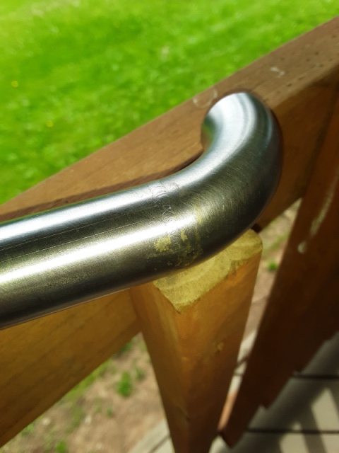

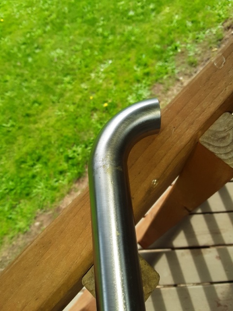

I am going to make a cargo roof rack and radar mount for hammerhead. I have lots of 304 ss tubing and fittings that I was planning to use, but after doing a quick test and dunking in salt water the tubing and fitting got small amounts of surface rust after only one day. I was surprised by this, because I see that lots of marine deck cleats and various fittings are offered in 304ss. The rust is just on the surface, and came off easily with just a scotch brite pad.
Is there a way to polish/ wax the railings so they do not rust, or do I need to use 316 material? Thanks!
