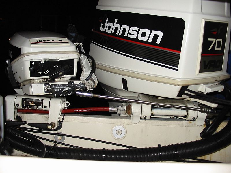

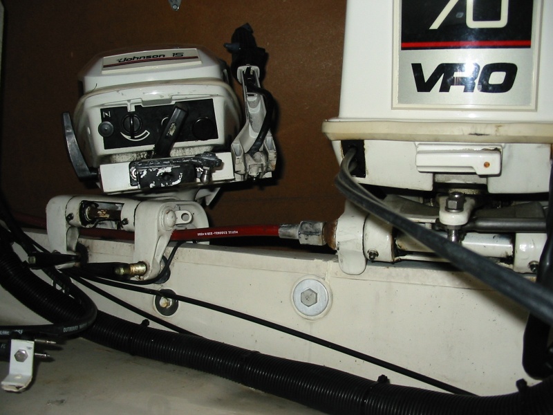

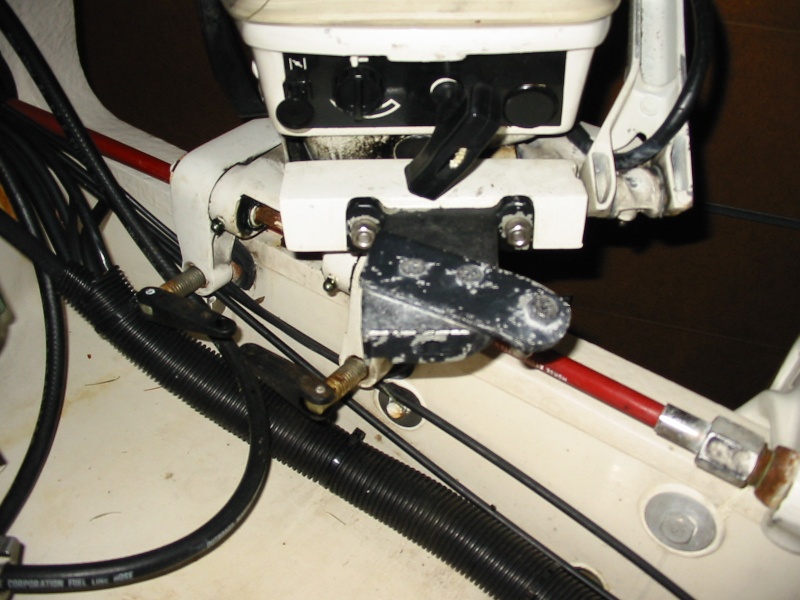

PostPosted: Fri Feb 10, 2012 3:40 pm    Post subject: Reply with quote
Here is the factory set-up on an '89. Long shaft. Motors tilt up/down together or separately.
Pete

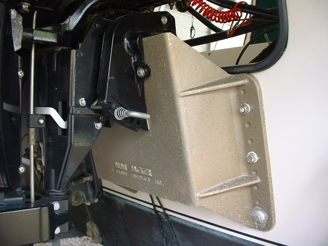

PostPosted: Fri Feb 10, 2012 5:03 pm    Post subject: Reply with quote
At first I mounted the kicker right on the transom, but didn't like it because of cable clearance and it drug in the water a bit when tilted up. Personally, I think the mini jacker is the way to go. It was inexpensive and easy to install. It raises the kicker up and aft a few inches so no more clearance issues. It's easy to tilt. I really like it. Yes, you set the angle of your kicker with an adjustable pin...just put the pin in whatever hole you need to get the angle you want. It can be seen in this pic. Be sure to seal up your mounting holes very well. I used 4200 fast cure. We also slave the kicker to the main so we can steer from the helm while trolling.
Rick
