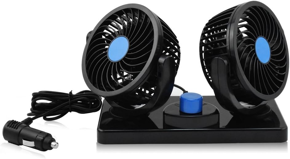

I mounted a set of fans on the dashboard in front of the passenger window. You can turn them to any position, including toward the glass. They are only $14.99 from Amazon and have worked great for over four years.
https://smile.amazon.com/Electric-Rotatable-Cooling-Circulator-Vehicles/dp/B08BZDPJKH/ref=sr_1_1_sspa?dchild=1&keywords=Dual+Heads+Car+Fan+12V&qid=1612227837&s=electronics&sr=1-1-spons&psc=1&spLa=ZW5jcnlwdGVkUXVhbGlmaWVyPUExUTM5R0daM0dMVkhDJmVuY3J5cHRlZElkPUEwMTUxMjM4MjJMMlZZVVdBVUFUUCZlbmNyeXB0ZWRBZElkPUEwNjY5NzY3MkRZTUtDTFNEMzhKUSZ3aWRnZXROYW1lPXNwX2F0ZiZhY3Rpb249Y2xpY2tSZWRpcmVjdCZkb05vdExvZ0NsaWNrPXRydWU=
