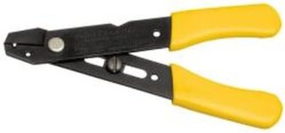

I don't use the automatic wire stripper that John links to. I prefer either my pocket knife and a light touch all of the way around the insulation, but also I use one of the all size strippers:
