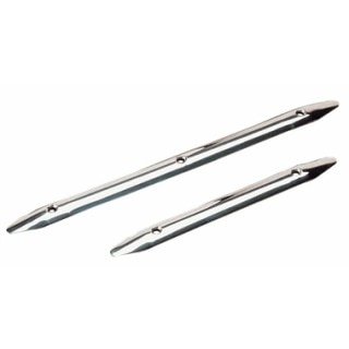

Chocks or fairleads can also be a point of chafe. I prefer to put a cleat on each side near the edge. Then a SS 1/4 round on the rail. Put any chafe protection there. I have a photo somewhere--or in the next day or so, I can take a photo my current 25 with that cleat on both sides.

Bob, what do you mean by "SS 1/4 round on the rail"?

. This is the quarter round rub strake I referred to. They are hollow on the inside, to conform to any rounding on a toe rail, if necessary. If the cleats are close enough to the edge of the gunnel, then not necessary.
