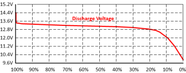

The discharge curve on the Li Fe PO4 battery keeps the voltage above 12.8 volts until it is 80% discharged and at 90% discharged it is still at about 12 volts. By the 10.8 voltage which was the end point for the study the battery was 95% discharged.
