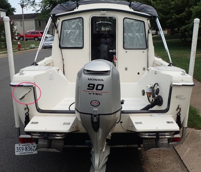

I added an additional factory swim step a couple of years ago. On mine there were 5 predrilled holes for mounting. I have seen two models of swim step. One has a solid piece where it attaches to the hull (i.e. full width) and one with a cutout. Mine was full width and had the 5 holes. This one needs to be cut out if you have trim tabs where the tab actuator attaches to the hull. I expect that the swim step that comes with the cut out is for boats that have tabs.
On my boat, the swim step is attached with through bolts for the top holes (2 ea). These bolts come through behind the fuel tanks. On my boat there was enough room for the bolts to be installed without removing the tanks, but it did involve some contortions. You can drill through the transom without removing the fuel tanks if you are careful. The bottom 3 screws are lag bolts that go into the hull and are not through holes.
After drilling into the transom you should take care to seal the holes with epoxy and all that as described in numerous posts on this site before installing the bolts. Also, on my installation there is a bead of 3M 5200 around the perimeter of the part of the swim step that is against the boat hull.
I did not have a drawing for installation either, but just installed it in the same place as the original one (just on the other side of the engine). It was about 2 afternoons of work to put it on.
This picture shows the installed swim steps. Added one is on the right side of the image. Since the C-Dory swim steps are kind of small I find it very nice to have two (looks better too IMO).
Yes, there is a difference in the gap between the step and the engine on each side. On my boat, the engine is not mounted on the centerline. The motor is slightly offset. This may be an error by the rigger, but I think it has to do with the countering the prop torque effect on the handling.
