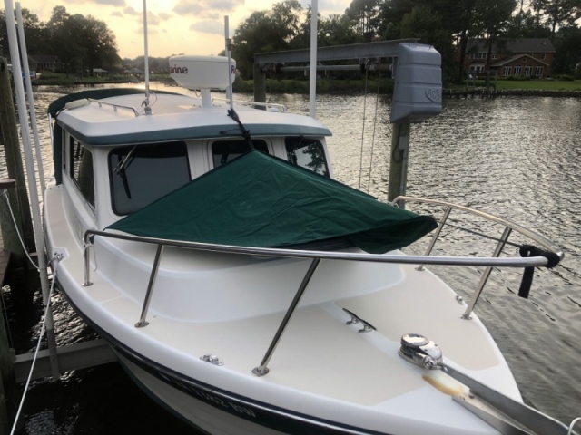

John Buss,
I saw your desire and went to my boat this evening and installed my bow shade for photos. The wind around me was 10 to 30 with gust from the remainder of Sally. I have used it many times, but never though to take a photo of it.
This Sunbrella cover was done by this boat's first owner, so no credit to me... There are screws in the bow rail to keep the line, both port and starboard aft and near the top. When I purchased the boat, I scratched my head several times, to why anyone would install screws in the aft top end of the hand rail. Once I found this in the boat, it became clear as to their purpose.
See my photos album to see the shade.

Steve, Hope it's OK to post one of your photos here for you. (There are 3 total on Page 3 in the album.)
Looks like a really nice and functional cover. If you lay that out flat, is it a triangle shape -- base over the windshield, and tip at the bow rail point?

Harvey,
You are correct...the general shape is a triangle. There is reinforcements at each strap location.

Thanks Steve. That is a slick idea.
