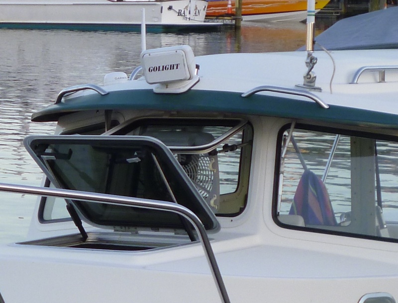

I did this to my boat, they are very useful. Sorry, don't have any pictures. It is an easy task. I just used fender washers. The brow on my boat is about 3/8" solid FG.
If you are adding rails, having some at the back outside roof top is also very handy. They are useful when getting onto the side walks from the cockpit and can be useful at the dock. I put 36" long rails on each side of mine. The rails bolt to the roof through the lip the runs outside of the cabin.

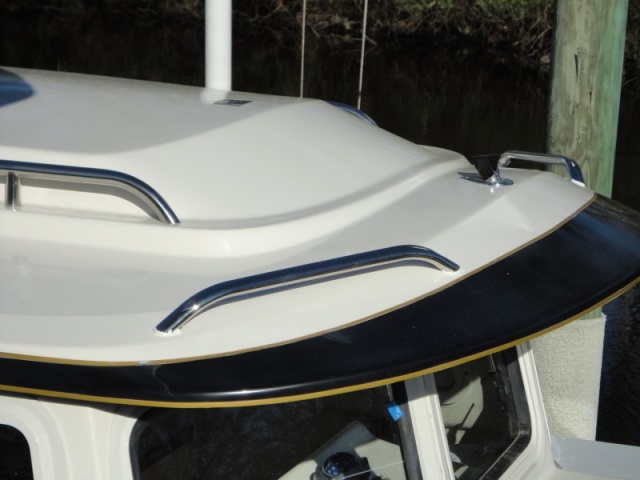

The hand holds are very useful. These are 11" on center, very study with regular size washers.
Photo in my album

Posts: 3592
PostPosted: Wed Sep 30, 2020 7:56 pm    Post subject: Reply with quote
Mine:
This image shows the rails at the back of the cabin roof:
