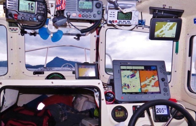

Harvey what’s with all the radios VHF We have 2 a portable and our main Jim w
Radio Free Sleepy-C right!!? Looks like monitoring two hailing stations and a commercial traffic station. Good idea in a congested area. As a comms nut, miss maria has radio envy of That “bridge”
PostPosted: Mon Jul 27, 2020 10:10 pm    Post subject: Reply with quote
Jim, Nigel is right. From left to right (port to stbd) across the top.
ICOM M-605 on VHF 16. Stays on that freq. CG monitoring, and hailing.
RayMarine 218 on VHF 7. Local Commercial traffic. Working Tug and boom.
Standard Horizon GX2150 on VHF 9. Secondary hailing channel.
and I do use a Hand Held, It was on my PFD;
Standard Horizon HX851 turned off but set on VHF 16.
I can only talk on one at a time, but with practice, you can learn to listen to 2.
And, the ICOM has "Last Call Record" function, so it stays on 16 ALWAYS.
Typical usage around home port, (crossing Juan de Fuca), 16 for CG and hailing, 5A or 14 for Vessel Traffic, 22 or 13 for secondary hailing or Bridge to Bridge, depending on traffic situation. Commercial traffic ranges from 6000 feet up to about 1200, and moves at 15 to 25 knots. It's good to keep track and in touch if needed.
