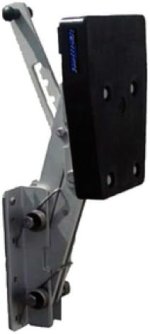

We have a swing down mount because since the 3.5 2 stroke is a short shaft we use for the dinghy. The mount we use is similar to this:
When we don't carry it there, we do as breausaw and put it on the railing. Same fo rate Torqeedo electric motor--which is a long shaft.
The swing down mount is on the Starboard side, a little inboard of half of the way between the outboard side of the transom and the splash well cut out. We bring the motor up on its tilt and then the bracket all of the way up for running. We do secure it with a line around the back of the gas tank.
