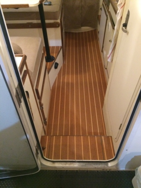

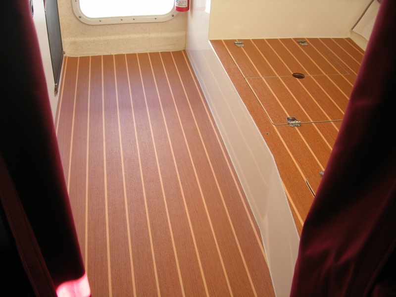

Several weeks ago I bought an 8' roll of teak & holly flooring that I installed in our Venture "Freedom" this weekend. Lots of nerves were at work while doing the job, but the effort was well worth it. We love the look. The material is made by Lonseal Marine. We used their Teak & Holly 70SE to cover the 3 areas in the main cabin. Mary wants me to later try covering the small area in the V-berth. We have enough material remaining to do so, but with our East Coast cruising plans quickly approaching that will be a job for next winter.... The toughest part of the job was the oddly shaped piece under the dinette area, which includes 3 hatches. We obviously wanted the stripes line up. Turned out it wasn't as hard as I had thought, just needed to methodically think it through and not rush. Of course, that is the way of most boat jobs. I've posted 4 photos of the final product in our Projects sub-album:
http://www.c-brats.com/modules.php?set_albumName=Our-Upgrades&op=modload&name=gallery&file=index&include=view_album.php
We did a lot of research before deciding on this particular material. I spoke with Lonseal a few times and was very pleased with their customer service, including their readiness to answer technical questions as I began the install. I ordered the material from Captain's Locker in Long Beach and they were also great to work with. Outside of the flooring material the only other necessary items were the Lonseal adhesive, a good straight edge, and dangerously sharp flooring knives. I am pleased to say I still have all of my fingers.
Before we actually bought the material we had noticed that Marc Grove (@ Wefings) had photos of a few boats with this material installed, so I asked him if it was reasonable to think it could be a novice DIY job. He quickly responded with encouragement so we moved forward with our order. We're very glad we did and thank Marc for his encouragement.

Harvey, we floated the material on the cabin floor but used an adhesive for the helm and dinette pieces. Even though the stainless hinges on those 2 pieces will help to secure them in place, the adhesive was desired so they couldn't flop around or have the edges loose to possibly trip up someone. When boating in rough water where good footing can be a trick, I wanted to be sure there was no additional tripping hazard. Our Venture has a flat floor in the cabin while I think the floor on the C-22 has a slight V. The Lonseal material is rather heavy - about 1/16" thick - and it's pretty dense. Because of this, I don't anticipate any problems having that section float. I'm guessing it would be similar in a C-22. Not to mention there is no place for the piece to slide because it's generally held in place on all 4 sides.

By the way, one other necessary tool I forgot to mention in my initial post is heavy paper for making the necessary templates. I used red rosin paper which can be purchased at Lowe's or Home Depot. Don't need much, but it only comes in long - really long - rolls. At least it's pretty inexpensive.
