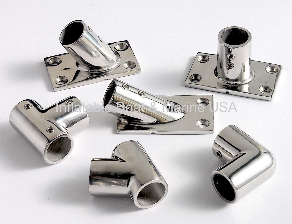

Buy the 10" piece of SS tubing or pipe. (3/4" or 1"). Use 45* EL. then a 45* foot pad all in SS, with Allen set screws. My rack is lower and between the sides of the splash well--I have made these several times. Use Bimini top fittings, or pulpit base fittings.
Below are some examples of the fittings available.
