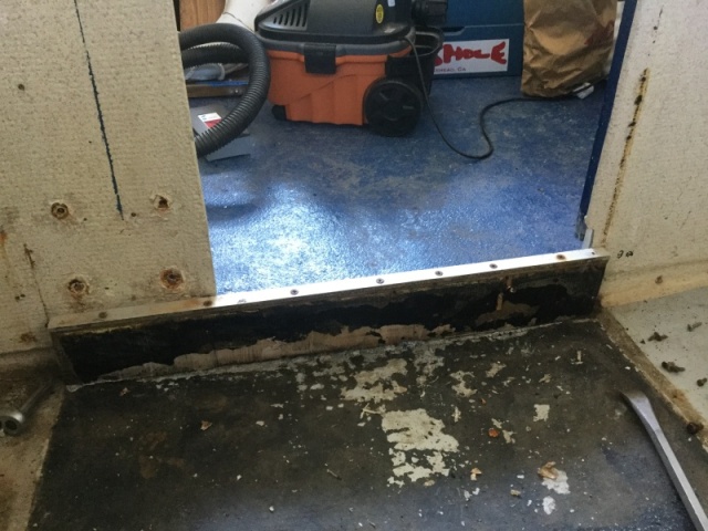

I have been working on re-doing the cabin area and came across something that does not look factory. I’m wondering if the previous owner cut the door shorter and put a plate in for some reason or??. What is original for my 87 Angler?
I posted pics in my album today so hopefully someone can send me a photo or know what’s correct.
Thanks in advance

Here is the picture of the plate in place:
and this one with the plate removed:
(cannot seem to get the other photo to come over.)
Not sure I can help, as my boat is newer. There is a box built under the door, and a bilge pump there. Makes a bit of a step below the door....
Good luck,

The second photo appears to be what it would have been originally. (judging by the rounded corners in the molding/cutout). The door does appear to have been cut off at the bottom. Perhaps there was some rot in the original area? Wanted a higher sill?
With your restoration, you probably would want to go back to the higher sill.
Thanks Harvey for posting the picture.
Bob,
I’m not sure if there was rot on the door or not but it sure seems shorter now that I have seen a picture of an original.
What would be the benefit of a higher sill? I thought of making a new door unless I’m missing something here.
Posts: 21497
PostPosted: Mon May 11, 2020 10:20 pm    Post subject: Reply with quote
The newer boats have a higher sill--it would be more likely to keep water out of the cabin from the cockpit.
As Harvey mentioned many have a sump bilge pump under a step which is inside of the door on newer boats. When water accumulates in the cockpit with the boat in the water, it will run forward toward the door.

I’m confused as to why they would design a cockpit floor that makes it easy for water to run forward to the cabin? Would It be ok to fiberglass the hole in the sill plate to avoid any water intrusion from the cockpit?
I also have a hole on the floor entrance to the v-birth that needs a plug- I think 1/2 inch brass. I’m assuming the original idea is that if water enters the v-birth somehow from underneath (rode locker) or ?? it had a path to the rear by removing the plugs? My cabin has never taken on water so I would think I’m ok to seal up the hole by the door. Thoughts?

"I’m confused as to why they would design a cockpit floor that makes it easy for water to run forward to the cabin?"
The floor of the cockpit, is also the top of the hull, and it tilts as the boat does, it is not an artificially elevated platform.
There are two "low points" in the boat. When running, at any speed above hull speed, the lowest spot inside will be the aft at the transom, due to the hull angle of the bow either up on plane or climbing to get up on and over the bow wave. When at rest in the water the stern of the cockpit will be higher than the forward edge of the cockpit, so water will run forward. That is when the forward bilge pump comes into play.

At some point around in the early to mid 2000 era C Dory began to make a removable raised floor (the inner hull as bottom of bilge remains the same). Then about 2006-2007 there came a permeant raised floor, but occasionally water would get under this, so the problem could still remain.
In my 22's I had two bilge pumps. One aft in a sump between the tanks, to take care of water when the boat was in a bow up attitude (running over 5 knots approx) and one for lower speeds at the forward end of the cockpit or just inside of the cabin.
Most put some grid on the cockpit floor (inner hull) such as "dry deck"--we used that with heavy duty industrial foam pads on top.
Keep the cockpit covered when the boat is not in use. Use a full cover or cockpit slant back.
I would recommend that you do the same. I would raise the threshold, make a step or box, for a pump intake which would suck any water out of the forward part of the cockpit floor/cabin.
The plug under the platform probably was placed there either from water from the anchor locker (often improperly sealed, too high a drain hole), or from a loose screw and penetration from attachment for the brass strip which helps to protect the stem of the boat.
You will determine if any of these have to be addressed in the future.

Harvey and Bob thank you for your input - I understand now.
I keep my boat under a fully Enclosed canopy when not in use and keep the trailer as high as it goes in the front just in case water does get in the cockpit somehow so it drains out the back.
Bob - if I do put a box in for a bilge at the cabin hatch where would I run the hose to pump out?
Or would it pump out to the cockpit deck via the hole below the door with some kind of one way check valve or flap so water does not enter from the cockpit to the cabin?
Posts: 21497
PostPosted: Tue May 12, 2020 10:23 pm    Post subject: Reply with quote
There are 3 ways I have seen this handled (there may be others)
1.) a box with a bilge pump in the box, and tubing going out the side of the hull under the galley. There at times is a one way valve in the discharge tubing--these keep water from flowing back into the box...but at times fail.
2). A suction pump under the galley with a "foot" in a small box just inside of the door. Both of these have the hole from the cockpit
3.) a suction pump on the side of the cockpit, with discharge slightly above it--and a hose and foot down in front of the door (with a small sump, and the hole between the cabin and cockpit sealed or with a removable plug.
The most common bilge pump is a plastic vane centrifugal pump--which is not self priming--and the vanes need to be in the water: Rule pumps are mostly of this type.
Second type is the diaphragm type: Jabsco (PAR) makes some of these. I used to have nothing but these on one of my sailboat s and always kept a rebuilt pump and a rebuilt kit handy. The valves can plug up and fail. But when working they will suck the bilge dry. Whale makes some diaphragm pump also. It is usually advised to have a centrifugal pump as a backup for emergencies,
There is a 3rd type of flexible vane pump--such as Jabsco "Waterpuppy". I use one of these for de-watering also. They are self priming and with a nitrile impeller be able to handle oils and fuel. These are self priming, but more expensive--and also more subject to failure. Flow rates often are lower, but they can push a higher head pressure.
