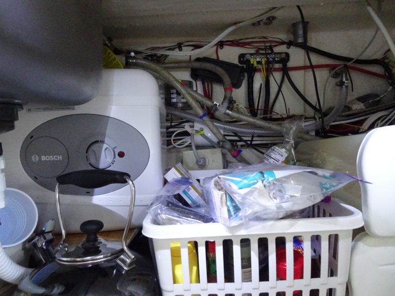

We (and a couple of other 25's) put in a Bosch 2.5 gallon water heater basically under the galley faucets. We epoxied in a plywood (saturated with epoxy) platform. We have a mixing valve in the shower, to keep temperature constant. I keep the heater near the max temp. (easy to adjust the temp). We waste less than an ounce or two of water when use at the galley. I have no idea why the factory doesn't put the Bosch in to begin with. It holds heat overnight, costs less, and works beautifully!

One of my first projects was to pull the space and water waster 6 gallon water heater and put a Bosch under the sink so much more efficient and an obvious solution to a lazy factory setup, I did mention it here in a post at the time that Bob noticed and tried it also, then verified how well this stup works. In our Ranger Tug at least it made some sense as the water was also heated by the inboard diesel.

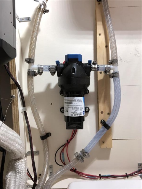

Well, I did it!
It works and it works well. The idea was to inexpensively add recirculating hot water to the boat (much like is done when retrofitting houses), so I can make use of the factory installed 6 gallon hot water heater. Until now, I never use the hot water heater because of the "wasted" 1.25 quarts of water it takes for the hot water to get from the heater to the galley faucet. This recir set up allows for near instant hot water (less than a second delay). The whole project cost less than $125, but it could have been done for under $50 (see below).
I did it by installing a fresh water pump under the galley. I was going to go with a cheap pump ($30), but the cheaper pumps would take 30 seconds to bring hot water to the galley; so I went with a more expensive one ($100). I didn't need to go that expensive, but I decided to go with the identical brand and model that is installed in the boat as my main fresh water system pump (Jabsco ParMax 2.9) since that way the new pump would do double duty as the recir pump and also as a backup main pump should the main pump ever fail. (BTW, I set things up so that I can have the new recir pump take over the main pumps duties by removing 3 hose clamped barbed fittings and running a 1/2" hose to bypass the failed pump -- uninstalling and reinstalling the pump is not necessary -- quick and easy fix until a more permanent fix can be done.)

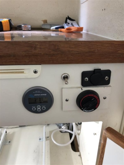

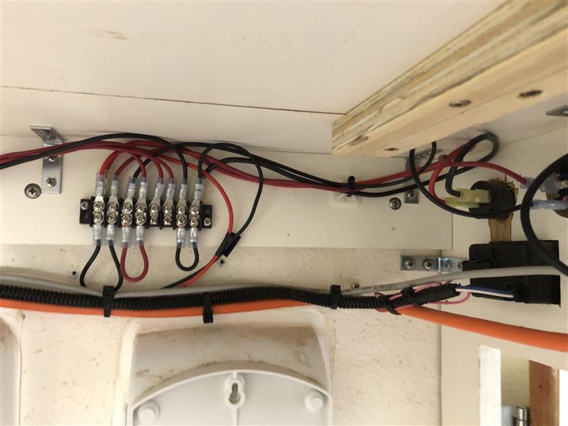

To make this work you must disable the pressure switch in the recir pump. I did this by cutting the wire that runs to the pump's "relay", and stringing all 4 resulting wires to a terminal strip. This way I can run the new pump as the recir pump or reconfigure it as the main freshwater system pump by simply moving some jumpers around on the lower half of the terminal strip.
To get "instant" hot at both the galley sink and at the shower, one holds down a momentary toggle switch for 10 seconds. No fuss, no waste. The down side is that since I use the cold water line as the hot water recir return line, once the recir pump does its thing, the cold line is partially filled with warm water (not hot if you time it right); but I don't find this a problem since I rarely want truly cold water anyway....even from the cold tap. My drinking water is a separate system; and of course, there is always the cool sea if I don't care about salt.
There are some other advantages to this system besides low cost over the alternative Bosch etc instant hot unit mounted under the sink:
1. It takes a lot less room
2. It makes use of the factory installed hot water heater that would otherwise not be used
3. I can easily control the temperature of the hot water coming from the faucets by how long I enable the hot water heater circuit.
4. The hot water tank is a sort of "energy storage" system since I can use surplus electrical energy to heat the water, and then reclaim that energy at a later time.
This last point is a bit subtle. Here's how it works. As part of these enhancements to my boat, I am also replacing the 1500 watt hot water heater element with a 1000 watt element. The reason for that is so I can run the hot water heater AND my 36amp battery charger at the same time off my Honda 2000i genset. I often need to run that genset for 30 to 90 minutes a day to recharge my batteries depending on whether I run the main engine that day or not. Since I can heat the hot water warm enough for dishes or a shower in 30 minutes with the 1000 watt element, I wanted to be able to run both the hot water heater and the charger at the same time (with a little genset head room to spare) .So now I sort of get the water heater "for nothing" since I am running the genset anyway. The charger needs 200-400 watts depending on the battery SOC, so if all I am doing is charging the batteries, a lot of the genset capacity is going to waste. True, the genset uses more gasoline at full running speed than under light load; but I consider that small amount of fuel as essentially free -- the "real" cost of running the genset is noise in the anchorage. So this way I get hot water for essentially the same amount of noise as I produce charging my batteries. Also the alternative Bosch-type systems must use a gob of amps out of the battery, and since I want to use the hot water while at anchor without creating even more noise, the hot water heater is a sort of "time shifter" of electrical energy.....if you get my meaning.
