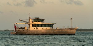

Interesting point about the water getting back out. Hmmm. In this video the guy talks about the trapezoid shaped stern and ability to empty water as being key in following seas, around 8:30. Not our boat but same concept on a smaller scale.

Sorry, here's the link I was referring to in the earlier post. BTW, this is a seriously cool boat.
https://www.youtube.com/watch?v=OgFEIevpbq0&t=450s
Again, around 8:30 he talks about stern shape effect on bow during following seas.
. Referring to "Cochise", Steve Dashew's FPB 78 his current and last power boat which is 86' long and only 20' beam. I doubt that "Cochise" would ever be confused for a C Dory. The hulls and dynamics are so much different. Cochise's hull remains a V, to rounded V aft to almost where the prop shafts emerge, then the stern is flat, almost like a long swim step, the HP to weight ratio are way off, Cochise is a displacement boat. The C Dory is a planing boat. Look at the stern--fully open, and very narrow for the length--C Dory enclosed and wide for the length... this 86 footer has very fine lines. Sorry, but the dynamics are entirely different.
I have known Steve (Skip) and Linda Dashew since the early 1970's. They are one of the brightest cruising couple in the world. His innovations and his voyages are epic. He has contributed a great deal to the world cruising base, starting with his first Deerfoot sail series. I have been privileged to have been aboard several of his boats from the first "Beowulf" (32' Class D sailing Cat), Intermezzo (Columbia 50), Deerfoot 70 and "Wind Horse", but not Cochise. His Marquesas Islands to San Diego (over 3000 miles) in 12 days in the 80' sailboat Beowulf is a record which I doubt will ever be surpassed, with a boat handled by a couple! (OK, I know that "foilers" are faster!)
Steve is probably a year or so older than I am. He and Linda are still cruising almost full time just the two of them, in an 86 foot boat! His father lived to be 96, and I would be surprised if Steve is still not sailing at that age!
