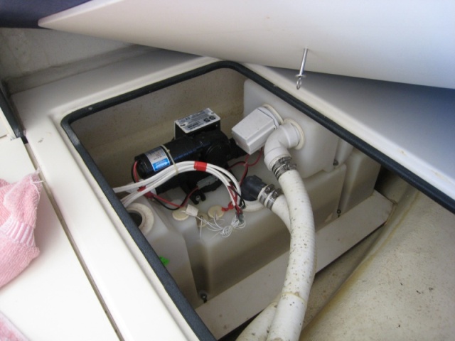

Does anyone know why the holding tank on the Tomkat is port side of the
berth rather than under the head? My friends have a 06 26’ Dory and their tank is under the head. This makes way more sense than pumping all the way to the front of the boat. Also would cut down on smell while trying to sleep.
Can it be moved without too much hassle?

We have an 06 Tomkat hull #15. The holding tank is a 25 gallon version under the port berth.
Our water tank is 40 gallons located starboard under the galley.

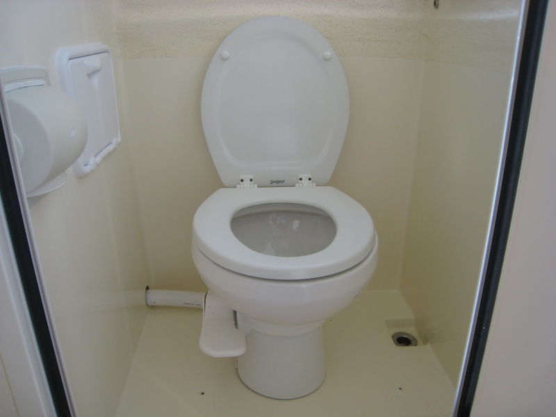

This would appear to be your holding tank, which is described as being 10 gallons by a prior owner. it is a vacuflush system, which uses fresh water.
If it is the 10 gallon, the dimensions would be: Height: 16 in./406 mm Width: 10.875 in./276 mm Length:32.375 in./822 mm. If it were the 27 gallon the dimensions would be: Height: 21.375 in./543 mm Width: 14.75 in./375 mm Length: 42 in./1067 mm It is possible that in 2006, there were some other tanks available, but unlikely.
The Vacuflush systems are shown here
Boats before yours had the SeaLand Dometic, I described earlier--and this is the same unit as in #12 boat, owned by Brent and Dixie.
Your boat had, or has the Westerbeke generator under the aft seat.
The actual commode pictured below is Acuflush.
I don't know if it was factory installed, or owner installed. (I would guess owner looking at the way the wiring was run. I believe that you would be the 4th or 5th owner--and I didn't trace down all of them. Your boat would have been started in January of 06 and probably delivered several months later. (However the hull numbers didn't always reflect the build slot--sometimes a dealer would order a boat and the hull number would be out of sequence.). My boat was hull build # 42 and started in May of 06.
The reason it was put under the port side of the berth is for reasons of access--that was the easiest place to service it. If you traced out and find the first owner, there may be some clues there as to why they wanted the Vacuflush system.
Personally, I would pull it out, and go back to the very simple system the factory used--the tank in the base of the commode. This would be 9 1/2 gallons.

Our boat is hull # 10, but actually the fifth boat built. Early hull #'s were reserved for customers preordering. We went to the factory and spent two weeks where I did much of the rigging (mostly electrical ) myself. We drove away with our new 2006 TomCat in mid December 2005.
Our head during boat rigging.

You do indeed have a ‘vaccuflush’ system, which pulls sewage away from a simple tank under the bowl by vacuum and therefore won’t smell every time one ‘flushes’ directly into an under-toilet 9 gal holding tank like Model 711 Traveller.
We had a Vacu-Flush on the last boat (Regal 2665) and it worked very well. Weak points were the rubber one-way ‘joker valves’ lasted only about 2-3 years and were a royal mess to replace. Also, no marine sewage hose should be expected by a reasonable owner to not ‘permeate’ or leak stink past the 10 year from mfg date (what date is stamped on YOUR hose?). The pump typically lasts 2 weeks past it’s 12 month warranty, plus or minus 1 week. The flush ball seals typically last 1-2 years and cost $38 to replace. See all at
https://www.environmentalmarine.com/find-your-rv-gravity-toilet/
You could replace your toilet very simply with a Model 711 Traveller Dometic/Sealand (they merged) RV gravity toilet like on our TC255 for around $750 new.
