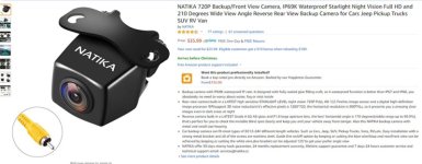

I have installed the camera's on my past boats.
The camera should have the highest rating for "wet" locations.
Most important, for a small boat with open windshield location " sunlight viewable screen". Cheapest way to get this is to find a model that plugs into a camera. These would have a sunlight viewable screen. Purchased off of ebay, 7" screen for about $ 250 dollars.

We have a 9" (not necessary to have that large but was already on the boat), monitor mounted form the ceiling, with the camera right above the door. The rig is by Tadi Brothers. I have a separate wired system (7" monitor), I use for the back up/trailering camera. I may convert the boat to "wired" also. We may move the camera to the top of the radar arch for a better view when the Bimini/full camping enclosure is in place.
PostPosted: Sun Dec 22, 2019 1:24 pm    Post subject: Reply with quote
I have a fairly small, curved mirror mounted up on the overhead shelf that I can use to see the cockpit. It was placed for being able to monitor that area if I had anyone with me, and was out back as we were steaming. It is not for watching for rear approaching traffic. (That is what the radar is for Rolling Eyes
I also have a camera that mounts just inside the door, facing out to see the cockpit, and traffic lanes beside and behind. The monitor for that is wireless and in the truck. This is a huge asset when towing, especially in congested traffic areas. The camera is an I-Ball, and I modified it to take a hard wire 12VDC power instead of the 9 volt battery which only gave about 3-4 hours of towing use. It plugs into the Cig lighter on the boat for continuous power for all day towing. Love it.

Bought a cheap one to play around with off Amazon while thinking about towing the nieces/nephew on a tube.
Clipped it to the overhang above the door and ran it into the video input of the Garmin chartplotter.
Held up well to being offshore and kept on a lift for several months.
The "clip clips" I used to hold it up rusted away, but the cam is still working fine.
Personally the angle is a little wider and more distorted than I was hoping for family videos, so I'm looking into a Garmin or GoPro type replacement for the future.

I have two cameras clipped to the roof overhang looking backward. They are outdoor security type cameras and look a little funny up there, but with the limited aft view on the original CD25 they are a big help for watching fish poles while trollng. They give me a good view of what is behind the boat, too.
My older 10" Garmin has two video inputs so I can set it to alternate between the two aft cameras or stay on either one of them. One of the cameras is also feeding the TV so the passenger can watch the pole on one side while the driver watches the other camera. I know, it's weird, but we are old folks and it rains a lot around here.
A third camera is in the anchor locker so I can watch the rode pile up when running the windlass. If it is anchoring season and not trolling season I have it fed to the Garmain at the helm and switch to it as needed.
Like I said, the cameras look a little silly up there in the back but they serve me well and I am not displaying the boat at the boat show so I'm good with them. However, this discussion got me looking at the backup cams on Amazon and I see the sizes, quality and prices are down quite a bit from when I last looked a few years ago. I picked out one to order and will try it out when the boat comes home for a spell after crabbing is done.
