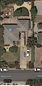

PostPosted: Wed Dec 04, 2019 7:25 pm    Post subject: Reply with quote
i've been thinking about converting my garage into another bedroom and adding on a monster garage for the boat.
My wife thinks i'm crazy... I'm not sure i'd even be able to get the thing inside with how narrow my street is.
