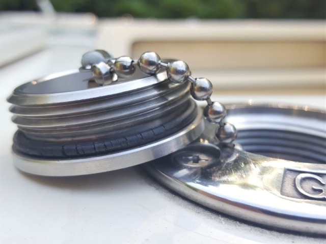

On our last trip, the marina gas pump attendant noticed the gas cap o-rings were quite deteriorated. Both gas caps as well as the water cap looked the same. I'm sure these are original (2005) and it's obviously time to replace them.

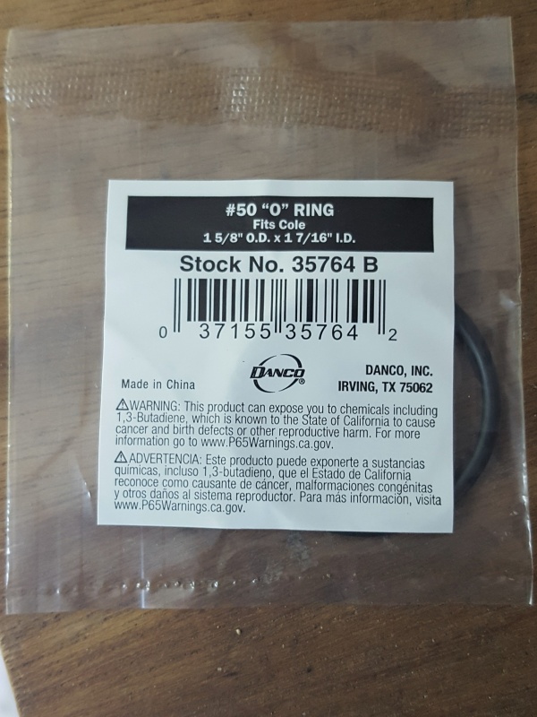

Replacements are 2/$12.49 at WM.
These are the same and available for $0.79/ea at Ace Hardware.

The o-ring in that bag is nitrile. It is compatible with gasoline...and water.

According to the Danco website the #50 o ring is made of "Durable rubber construction". So is nitrile a rubber? Not trying to stir the pot, just trying to get a gas resistant o ring.

Description of Danco #50 O ring:
Made from Buna-N rubber to provide superior resistance against abrasion and water swell.
Buna N rubber is Nitrile. So Little Wing is correct that the O ring is Nitrile.
"Rubber" is a bit ubiquitous (a polymer with viscoelasticity) --we normally think of "rubber" as a material made from Latex, and a natural rubber. However, Many items are also described as "silicone rubber", Neoprene Rubber, "EDPM rubber" or "nitrile rubber". The latex product from a plant is more likely to be described as "natural rubber". There can also be some synthetic compounds described as Latex.
