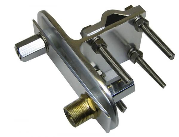

I have used Ham sticks in dipole configurations. This gets past the ground plane issues. The MFJ-347 dipole mount makes the installation easy. I have also used Hustlers in a dipole configuration, before the Ham Sticks---(since the 80's). The issue with the Hustlers is that they have pot metal and tend to corrode in the marine environment.

A dipole uses two equal tuned radiators. The "ham Sticks" are tuned for the band: 75 meters for the 3968 Mhz Sonrisa net, the 40 meter for 7238.5Mhz (Baja Net), 7.194(Chubasco Net) and the 20 meter for 13,300 Mhz (Maritime Service Net). Times and frequencies vary by time of the year.
The dipole is somewhat bi-directional--so you have to have the two antennas, at right angle to the direction of the station if used in the horizontal plane. If used as verticals, there will be variable bounce, but less directional.
The connector is:
The antenna feed PL 259 got into its socket--and the 3/8" base thread of each "stick" goes into one of the two hex elongated "nuts".
The antenna: You need two for each frequency: They are changed by frequency. No tuner necessary. (or a small manual tuner can be used, such as MFJ-971 (this is 6" x 6" x 2"--and ideal for transceivers such as the IC 760.
Combined they are like this:

I think I see what you you are describing but two different systems one with the ham sticks which need to chane for each band and tend to be directional but no ground plane foil needed I thought?
The second one you have all three single band antennas permanently mounted without its opposite paired dipole antenna on a strap isolated from the arch? Then you don't need to change anything when you are on different bands? But does need a tuner?
I don't understand the part about taking the ground from the "feed" do you mean to the shielding somehow? Or are the 3/8 nuts isolated and then run to the arch/ground plane as the mounting strap is isolated? Or am I missing a separate ground wire. I am very familiar with running a foil ground, but from an auto adjusting tuner. I still have the one I took off the Tug that had a 21 foot whip. But it wouldn't be anywhere near the arch?
Thank you for your help and the photos. Micah

Yes, one is the dipole system--and the other is using 3 different band antennas at the same time.
To attach the PL 259 connector to the antenna will require a SO-239 TO 3/8" x 24 THREADED STUD ANTENNA MOUNT ADAPTER
My Radar arch had several SS plates on the top welded to each side of the legs, with a 1/2 hole drilled in the center of the plate for the SO 239 fitting (see above) to pass thru, and then the ring nut tightened on the bottom of the connector, finally the PL 259 was attached and snugged up tight.. I then used piece of SS rod threaded to 3/8" on each end, Lock nutted into the top of the fitting, and then the tip into a long 3/8 nut, which passed thru the center of the 1" x 12" SS plate (bent, and with the antennas on it. This is all part of the radiator. The transceiver is feeding the threaded rod, the plate and the 3 radiating elements. The ground is thru the coax of the feed line, as well as the copper foil which will be attached to the radar arch, as well as to the ground lug of the IC 706 chassis.
The dipole is far easier to build. A lot depends on how big your radar arch is, and if there is provision for a plate to hold antennas. You have to have at least 3 feet from other antennas on the arch. The boat I built my 3 radiator system had a beam of over 12' and the radar arch (all of the way aft) was over 10 feet across the top--so there was plenty of separation between the radar, and other antennas on the arch.
