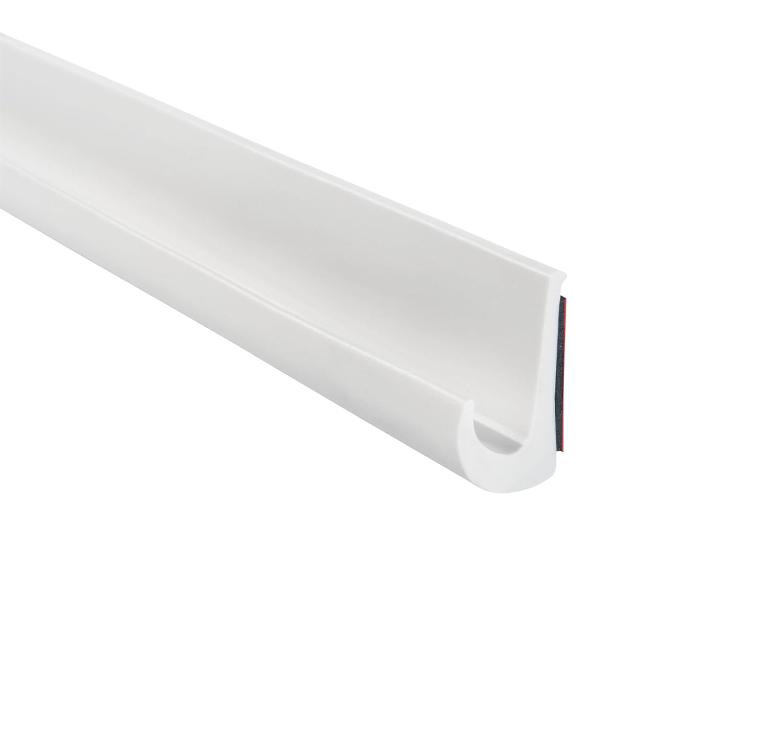

I put a photo of my "press on rain gutter" and a little explanation in my folder. The stuff is available from places like Grainger and Zoro.
Another simple solution might be a peel-and-stick gasket or weatherstrip aft of the common sense fasteners. It might have to be replaced once in a while, but it doesn't involve grinding fiberglass.

If you think you need a rain gutter, it is available thru any RV dealer: This is a press on, with 3M adhesive:
