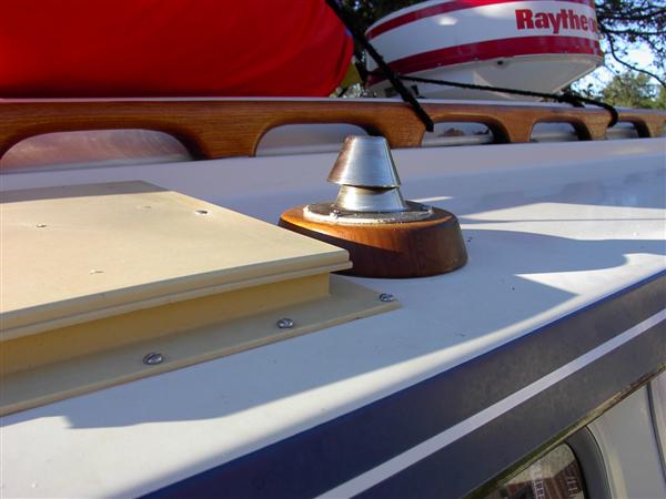

I know you said you didn't want comments about putting the exhaust stack on the rear of the roof, but, to me, at least, that's the most logical, safest place on the boat.
Would placing it there inside a second tube (double insulated) keep your inflatable (and anything else) protected from the heat?
At the same time, the carbon monoxide would be vented at the best possible point on the boat.
Could be a simple stainless or painted steel tube around the usual vertical self-drawing flue tube with the usual top fitting hidden inside.
e.g., put another tube around something like this:

PostPosted: Wed Mar 27, 2019 12:35 pm    Post subject: Reply with quote
Another advantage of the roof stack is that you get the exhaust heat into the cabin for the length of the stack up to the cabin top.
PostPosted: Wed Mar 27, 2019 4:04 pm    Post subject: Reply with quote
And, you can put a small blower facing the tube and maximize the heat exchange from the flue to the cabin air. I used two computer "muffin" fans.
The blower will not only give you more heat in the cabin, but also reduce your final exhaust temperature.

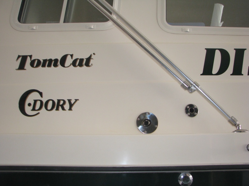

You don't say what type of forced air furnace? I put an Espar Airtronic D2 in 'Discovery'. It's under the galley cabinet, behind the sink. I also have a Wallas Stove. I exited the Espar exhaust through the starboard side above the walkway and just behind the Wallas exhaust. I don't have to worry about burning fenders as the exhausts are above the walkway and above where fenders are usually placed.
