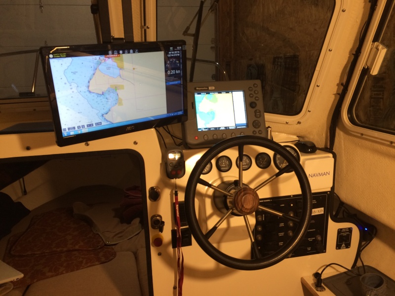

Whoa! Just said my head was spinning, did not say I was about to dive in! Although at some point I think I pretty well have to! Right now all my 2005 vintage Raymarine C-80 will be used for is to provide its NMEA 0183 data multiplexed with my AIS's data to my laptop running Coastal Explorer, which has a USB monitor mounted above the helm for display! Running everything on a Raspberry Pi would seem to be a logical next step, except it can't run Coastal Explorer, and I really do not see OpenCPN as quite as capable! I have OpenCPN on my MacBook as a backup should my Toshiba fail, however.
I actually have lowered the monitor a bit so it doe snot block the center window quite so much. The laptop is on the shelf behind the center window and runs with the lid closed. I have a wireless nouse and keyboard for it, although I really only need the mouse.
I can imagine the C-80 gone, perhaps a little smaller monitor mounted where the C-80 now sits, and all the hardware behind the helm or up in the electronics shelf.
But this sure seems like the logical next step! One blackbox that reads the inputs from GPS, depth sounder, radar, whatever, and sends everything via wifi to the computer, my iPad or iPhone, where I can control everything!

Pat,
The setup of your 25 is about the same as the one I sold. What I did different was moving the C-80 to where it was just to the left of a radio mounted on the underside of the shelf over the helm. That let me put the monitor right where your C-80 is now by using a RAM mount. I used a wireless track ball that mounted with velcro where your mouse is. The S100 remote was in the same place. That way nothing blocked the view out the front.

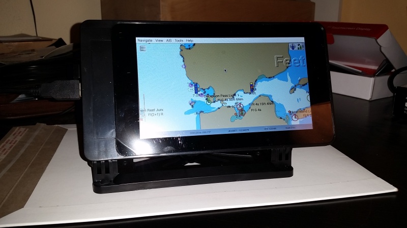

I've set up a backup touchscreen chart plotter using the following components:
Raspberry Pi 3 @ $40
Raspberry Pi 7" Touchscreen Display @ $60
Smarticase for the touchscreen display @ $25
GlobalSat BU-353-S4 USB GPS Receiver @ $30
OpenCPN vector graphics charting software @ $00
Getting the software to run was a bit of a challenge, but there is a lot of online info to help you through the install.
The GPS puck was plug and play. OpenCPN recognized it right away.
I’m hoping to incorporate AIS and radar overlays with input from my Standard Horizon VHF, and my Garmin radar.
