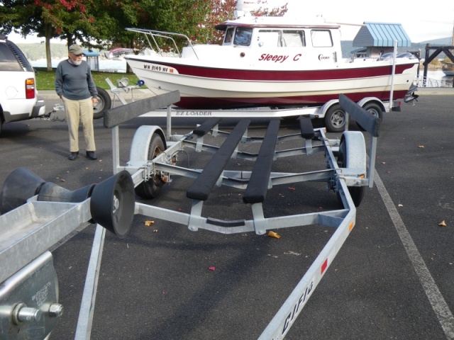

PostPosted: Sat Jun 29, 2019 4:11 am    Post subject: Reply with quote
WOW, I don't think I have seen a C-Dory trailer with only 2 bunks. That would seem scary to me. Here is a pix of mine after I replaced and re covered my bunks. This is on my first (single axle, Pacific) and I have since changed to a tandem Pacific. On that one I have lowered the bunks 3 inches and it rides better, launches easier, and is easier to get on and off the boat when it is on the trailer.
BTW, both of these trailers had 4 bunks, the 2 shorter ones outer and aft and the long ones center. All four line up to end right under the transom.
Posts: 4916
PostPosted: Sat Jun 29, 2019 11:26 am    Post subject: Reply with quote
Good morning Harvey. The Ez-Loader bunk trailers only came with two bunks.
A Fishin C
Guest
PostPosted: Sun Jun 30, 2019 3:32 pm    Post subject: Reply with quote
Two bunks on my trailer is perfect. I think they are 12 feet. The boat transom should sit one inch over hang off the back of the bunks. See my picks. Trailer needs to be minimum 25 feet long. Adjust bunks so boat level on trailer. Adjust winch post for bat situation. Adjust winch so that the boat eye and strap are under the winch post roller. And you need the side bunk guides the longer and higher the better.
