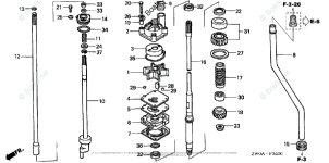

Thanks. Yes, I've been looking at the diagrams on boats.net. But I guess what has me still scratching my head are those 2 seals and o ring for the drive shaft, as shown here, parts 32 and 36:
The photo in my post above, was taken right after I lifted the old water pump out. I didn't see 2 seals or o ring anywhere... and not stuck to the bottom of the old pump housing either, or inside. So that's why I'm scratching my head on this. And apparently they're not visible in my pic either. So where are they? Hmmm.
I replace gear oil in Spring and in Fall and haven't had any water intrusion into the gear case, so they have to be there. Well, I'm waiting on delivery of all the lower case seals, so when I get them I'll open it back up and try to figure out where the heck those seals are.
Thanks!

OK, I feel dumb. Embarassed Just checked the video I shot when disassembling... on the bottom of the housing (part 6, which is not included in the water pump kit) I see a red ring which I think is the water seal. Not sure about the O ring, there's a black rubber-looking ring, but if that's the O ring I don't see why there would be those 4 visible breaks, near the 4 round castings. Maybe that metal ring pulls out and the o ring is underneath. Oh well, I'll pull it apart when I get the seals but at least I have a much better idea now. Thanks again for the help.

You'll see the o-ring when you take the water pump off. It seals between the outer diameter of the cylindrical shoulder on the bottom of the water pump, and the housing for the lower unit. You can't see it in the photo, but if you tilt the pump 45 degrees, you can't miss it. The surface you're mistaking it for is actually metal, and part of the water pump casting. Hang in there.
