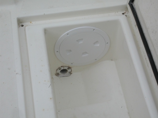

The above image is from the "Dreamer" album, but I did the same modification to the fish box's on Discovery. It allows better access to the macerator pumps, also to the bilge pumps.
Use a 6" screw-in type deck plate. Get a plate with an "O" ring, and use 4200 to set the plate in. They don't leak if well bedded with 4200, and contain a good "O" ring.

Thanks for the replies. That mod looks good.
